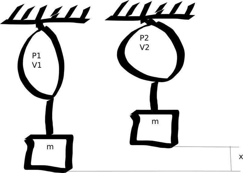

Let's consider a balloon that is fixed in one end at the ceiling and the other end has a load F=mg. The balloon has volume V1 and initial pressure P1. The mass is at height 0 (reference point). We then blow air into the balloon and the pressure inside it increases. The mas then raises a distance x. What is that distance? What about if the pressure is kept constant and take the load off instead?
I draw something to make it clear.

LoopInt said:
Sure, that's very nice of you.
Let's consider a balloon that is fixed at the ceiling and the other end has a load F=mg. The balloon has volume V1 and initial pressure P1. The mass is at height 0 (reference point). We then blow air into the balloon and the pressure inside it increases. The mas then raises a distance z. What is that distance? What about if the pressure is kept constant and take the load off instead?
I'm requesting that you think of a simpler problem than this one (one that is also capable of illustrating your issue). If we're dealing with a balloon, then we have to consider the stress/deformation behavior of the balloon material (which affects the force, pressure, and movement of the mass). We would also have to consider the non-linear kinematics of the balloon deformation, which is going to involve large changes in balloon curvature and large inhomogeneous deformations of the balloon membrane. I would like to avoid this complexity.
Might I suggest some sort of simple problem involving a gas, piston, and cylinder, with possibly surroundings pressure or force external to the piston.

P=nRT/V = nRT/(LA)
the force, then, is:
F=PA = nRT/L
But as I lower the weight by x, the height is L-x so,
F=nRT/(L-x)
Carrying the integration from x varying from 0 to d (maximum distance)
W = nRT Ln(L/(L-d))
Your force balance(s) do not look correct. Let C be the downward contact force exerted by the mass M on the piston. Then the force balance on the piston of mass m is:
[tex]PA-mg-C=0[/tex]
And the force balance on the mass M is:
[tex]C-Mg+F-P_0A=0[/tex]
At time zero, C=P0A and P=P1, so
[itex]P_1A-P_0A=mg[/itex] at time t = 0 and
[itex]F=Mg[/itex] at time t = 0
If we add the force balance on m to the force balance on M, we get the overall force balance on the "stack:"
[tex]PA-mg-Mg+F-P_0A=0[/tex]
or
[tex]F=(m+M)g-PA+P_0A[/tex]
Now, since downward movement is taken as positive, the differential work that the hand does when the stack moves down dx is -Fdx. Therefore, let's multiply the previous equation by -dx:
[tex]dW_F=-Fdx=-(m+M)gdx-PdV+P_0dV[/tex]
where dV=-Adx
Now, the next step is to integrate this equation from x = 0 to x = x (the final x) to get WF the work that the hand does on the stack, and -WF the work that the stack does on the hand.
After we finish this problem, we can do the irreversible problem of letting the mass M spontaneously fall from its initial position just kissing the top of the piston until it reaches its final equilibrium position. The results will not be the same. Now, won't that be fun?
Chet
What I did was do the overall force balance directly. It equal to your force balance, but I considered the piston to be massless, wrongly.
The work done by the piston on the gas should be nRT Ln(L/(L-d)), right?
What you calculate is the work your hand is doing, isn't it?
Oh. OK. You had mentioned something about 2 force balances, so I got confused. So I think we now have the same force balance, correct?
Correct.
As I said, "WF the work that your hand does on the stack, and -WF the work that the stack does on the hand." So the answer to this question is Yes.
I think you've gotten what I wanted you to get out of this problem. I leave it up to you to complete the other integrations on the right hand side of the equation. But, just as a matter of summerizing, one good (practically fool proof) way of figuring out the amounts of work done (so that you get all the signs correct) is to start out with the force balance and then integrate the equation over the displacement.
If you are interested in continuing, we can do the irreversible problem in which, rather than lowering the weight gradually by hand, we just release the mass M and let it drop. We would be focusing on determining the work done by the gas on the piston, which is different for this case from what we got when we lowered the mass gradually. Any interest in continuing? If not I understand.
Chet

OK. Let's continue. In the case we are going to be looking at next, the force F exerted by our hand is going to be zero, and the mass M is going to be dropping spontaneously, along with the piston. So there is going to be a mass times acceleration term in the force balance.
In addition, since the deformation is going to be irreversible, the gas pressure within the cylinder is going to be non-uniform. So we cannot apply the ideal gas law to the gas within the cylinder. Also, since the gas pressure is varying with position, rather than calling P the pressure throughout the gas within the cylinder, we are now going to call P the pressure of the gas on the bottom surface of the piston (this is the interface of the gas with its surroundings). By Newton's third law, this pressure will also be the force per unit area exerted by the piston on the gas. This interface pressure is what we will use to calculate the work done by the piston on the gas. Initially, P = P1, and finally, P=P2 (since in the initial and final equilibrium states, the pressure of the gas is uniform).
So. Please take the force balance that we derived for the quasi-static case, and modify it appropriately to obtain the force balance for this case.
Chet
The force balance is
-P0A+PA-(M+m)g=m1a
Initially
-P0A+P1A-(M+m)g=0
then
-P0A+P12A-(M+m)g=m1a
and finally
-P0A+P2A-(M+m)g=0
How can we proceed?
-P0A+PA-(M+m)g=m1a
What's m1? Also, I'd like "a" to be measured downward so that a = d2x/dt2
Initially
-P0A+P1A-(M+m)g=0
This equation is not correct, because there is instantaneous downward acceleration as soon as the mass M is released. However, initially, -P0A+P1A-mg=0
and finally
-P0A+P2A-(M+m)g=0
How can we proceed?
So what I get for the force balance is:
[tex](m+M)\frac{d^2x}{dt^2}=(m+M)g+P_0A-PA[/tex]
In this "dropping mass" problem, I'd like to confine attention to the case where P0=0 so that there is vacuum within the room surrounding the cylinder. This gives:
[tex](m+M)\frac{d^2x}{dt^2}=(m+M)g-PA[/tex]
For the initial state at t = 0, P=P1=mg/A
and, for the final state, at t →∞, P=P2=(m+M)g/A
So, P2/P1=(m+M)/m.
Now, what we are going to try to do is to use the force balance equation to determine the work that the gas does on the combination of masses, or the work that the masses do on the gas, from time t = 0 until the system re-equilibrates at the new equilibrium state. As in the previous problem, this is going to involve an integration. To get the ball rolling, I would like you to multiply both sides of the equation by dx/dt, and then to recognize that the resulting left side of the equation is an exact differential. (I hope this makes sense). If you recognize this exact differential, I would like you to rewrite that term in terms of the exact differential. If not, I'll fill in this step.
Chet
The m1 was the mass I didn't know what it was. Now that you wrote, it makes sense its m+M (total mass involved).
Yes, I forget that in that initial case M was not involved.
Since (m+M) d^2 x/dt^2 = (m+M)g−PA we need to multiply that by dx to get the work
\delta W = (m+M)g dx−PAdx
but we need to integrate over time so dividing by dt and multiplying by dt (chain rule)
\delta W = \int ((m+M)g dx/dt−PAdx/dt) dt
This is strange... I don't know how to proceed the integration
However, since dE=\delta W-\delta Q
for the case of the mass dropping fast, the system don't have time to exchange heat with the surroundings, so \delta Q = 0
dE=\delta W implies that dE=dW, thus an exact differential. Is that correct?
  • #31
Good try, but no. What you are calling ΔW is really the change in kinetic energy of the masses. We want to determine the work done by the gas on the bottom face of the piston. This is the work W done by the "system" on the "surroundings" (since we regard the gas as the system, and everything else as the surroundings). That work W is given by:
[tex]W=\int{PdV}=-\int{PAdx}=-\int_{t=0}^{t=∞}{PA\left(\frac{dx}{dt}\right)dt}[/tex]
We can find this work by first multiplying the force balance by dx/dt to obtain:
[tex](m+M)\frac{d^2x}{dt^2}\left(\frac{dx}{dt}\right)=(m+M)g\left(\frac{dx}{dt}\right)-PA\left(\frac{dx}{dt}\right)=-\frac{(m+M)g}{A}\left(\frac{dV}{dt}\right)+P\left(\frac{dV}{dt}\right)[/tex]
The left hand side of this equation is an exact differential, so we can rewrite the previous equation as:
[tex]\frac{d}{dt}\left(\frac{(m+M)}{2}\left(\frac{dx}{dt}\right)^2\right)=-\frac{(m+M)g}{A}\left(\frac{dV}{dt}\right)+P\left(\frac{dV}{dt}\right)[/tex]
Rearranging this equation gives:
[tex]P\left(\frac{dV}{dt}\right)=\frac{d}{dt}\left(\frac{(m+M)}{2}v^2\right)+\frac{(m+M)g}{A}\left(\frac{dV}{dt}\right)[/tex]
where v is the velocity of the combined masses dx/dt. The left hand side is rate at which the gas is doing work on the two masses, the first term on the right hand side is the rate of change of kinetic energy of the two masses, and the second term on the right hand side is the rate of change of potential energy of the two masses. If we integrate this equation from time t = 0 to arbitrary time t, we obtain:
[tex]\int_{V_1}^{V(t)}{PdV}=\left(\frac{(m+M)}{2}v^2\right)+\frac{(m+M)g}{A}(V(t)-V_1)[/tex]
where we have made use of the initial conditions that v = 0 and V = V1 at t = 0.
Let's discuss what's happening here. After we release the masses, they will speed up, reach a maximum downward velocity and then slow down until they reach a maximum downward displacement where they come to a stop. But when they get to this bottom location, there is now a net upward force on them, so they start moving back upward again. They speed up, reach a maximum upward velocity, and then slow down until they reach a maximum upward displacement. But, when they get to the upper location, there is now a net downward force on them, so they start moving down again. The net result of all this is that the masses will oscillate up and down, very much as if they were in simple harmonic motion.
However, even with the piston being frictionless, the amplitude of the oscillation will decrease over time as a result of viscous dissipation within the gas. The details of how this happens is unimportant for our purposes, except that, as time progresses, the velocity of the masses will progressively decrease, and at very long times, it will become equal to zero. Therefore, at final steady state of the system, we will have:
[tex]W=\int_{V_1}^{V_2}{PdV}=\frac{(m+M)g}{A}(V_2-V_1)[/tex]
Amazingly, the work from the initial to the final equilibrium state reduces to this very simple equation.
I'm going to stop here an let you digest what I've presented, as well as let you ask any question you might have. When you're ready, we can continue. We will be looking at both adiabatic and isothermal compression resulting from releasing the mass M.
