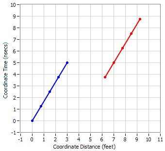

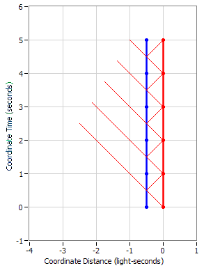

I think it would be most helpful to look at a pair of spacetime diagrams for a five-foot long object first at rest and then moving at β=0.6. Here's the first spacetime diagram:
Each line represents an end of the five-foot long object. The dots represent 1 nanosecond increments of time. Note that the delta Proper Times are equal to the delta Coordinate Times. I have shown the object over a period of 4 nanoseconds.

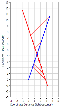

Now the spacetime diagram transformed to a speed of -0.6c (β=-0.6). This makes the object move at 0.6c in the diagram:
This diagram was created by taking the coordinates of each event (dot) from the first diagram and transforming them with β=-0.6 (c=1). You can see that the length of the object at any Coordinate Time is 4 feet. For example, at the Coordinate Time of 5 nanoseconds, one end of the object is at the Coordinate Distance of 3 feet and the other end at 7 feet for a delta of 4 feet. Gamma at -0.6c is 1.25 so if we divide the Proper Length of 5 feet by 1.25 we get the Contracted Length of 4 feet.
For Time Dilation, we can see that the period from the first event along the blue end of the object to the last event in the moving frame is 5 nanoseconds whereas it was 4 nanoseconds in the rest frame for a ratio of 1.25, the same as the gamma factor.
Now if you want, you can use your second set of equations to transform the coordinates of the events in the second diagram back to the coordinates in the first diagram using the same value of beta, -0.6.

For example, in my first diagram, take the top blue event as the first event and the second up from the bottom on the red line as the second event. Then Δx = 5 and Δt = -3. Remember that β = -0.6, c=1 and γ = 1.25. Plugging these values into your first two equations, we get:
Δt' = γ(Δt - βΔx) = 1.25(-3 + 0.6*5) = 1.25(-3 + 3) = 0
Δx' = γ(Δx - βΔt) = 1.25(5 - 0.6*3) = 1.25(5 - 1.8) = 1.25(3.2) = 4
Notice that Δt' equals zero as it should to get the correct distance between the two ends of the object.

I'm not sure why you said this. If you're talking about contracted length, then you should say "Δx' between the blue and red lines yields the contracted length when Δt' is zero".
If you're talking about Time Dilation, you don't want to go between the blue and the red lines, each line has its own Time Dilation and it's not necessarily when Δx' is zero. The Proper Time is when the two events are at the same Coordinate Distance in the rest frame of the object but in the moving frame, both Δx' and Δt' are non-zero.
You can see in the rest frame, the blue line depicts a coordinate interval of 4 nanoseconds and the red line also depicts a coordinate interval of 4 nanoseconds. You can think of each line having its own clock that ticks through 4 nanoseconds of Proper Time equal to 4 nanoseconds of Coordinate Time.
In the moving frame, the blue line events go from the Coordinate Times of 0 to 5 nanoseconds for a Coordinate Time interval of 5 nanoseconds (while the Coordinate Distance goes through 3 feet). The red line events go from the Coordinate Times of 3.75 to 8.75 nanoseconds for a Coordinate Time interval of 5 nanoseconds (while the Coordinate Distance also goes through 3 feet). As I said before, we determine the Time Dilation as the Coordinate Time interval divided by the Proper Time interval. In these cases (for the blue and red lines), the Coordinate Time intervals are 5 nanoseconds while the Proper Time intervals are 4 nanoseconds making the Time Dilation factors for both the blue and red lines be 1.25.

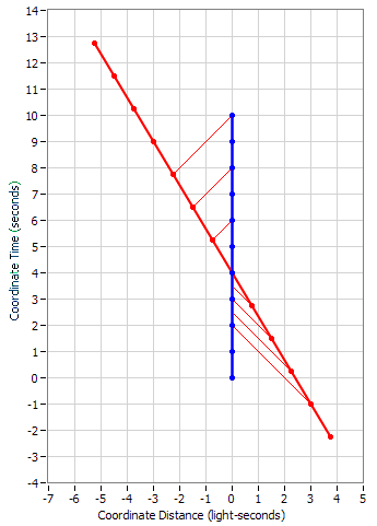

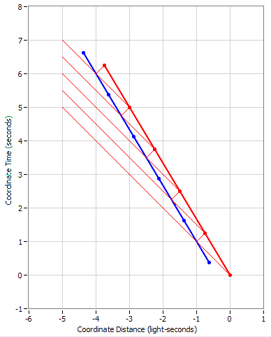

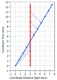

Here, let me illustrate with a couple spacetime diagrams showing two inertial observers approaching, then passing each other at a relative speed of 0.6c. They each have a clock that ticks once a second and they can each see the other ones clock as well as their own. Here's the spacetime diagram for the rest frame of the red observer as he is watching the ticks on the blue observer's clock:
At the bottom half of the diagram, the blue observer is approaching the red observer and the red observer sees the blue observer's clock ticking twice as fast as his own. We can calculate this Doppler factor using your formula, γ(1+β). Since at β=0.6, γ=1.25, and the formula evaluates to 1.25(1+0.6) = 1.25(1.6) = 2.
But note that the time dilation of blue's clock is 1.25 (gamma) which you can see by observing that in 5 seconds of Coordinate Time, blue's clock has ticked out 4 seconds and 5/4 = 1.25.
After blue passes red, red observes blue's clock ticking at one-half the rate of his own clock which is the inverse of the previous Doppler factor and yet the Time Dilation of the blue clock remains at 1.25.
Note that there is no Time Dilation of red's clock, it ticks at the same rate as the Coordinate time because it is at rest in this frame.

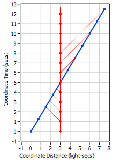

Now let's look at how the blue observer looks at the red observer's clock:
Note that during their approach, blue sees red's clock ticking at twice the rate of his own, even though red's clock is not Time Dilated in this frame. And after they pass each other, blue sees red's clock ticking at half the rate of his own.
Each observer sees the same Doppler shifts in the other observer's clock but neither observer is aware of the Time Dilation.
Does this remove your discrepancy?

I think it might help you to see how a light clock would function when in motion. First, a stationary light clock:
Note that the burst of light is traveling back and forth between two mirrors that are spaced one-half light-second apart. When it hits the blue mirror, a little bit of the light leaks out and serves the purpose of our clock that emits a signal every second. Note that the length of the light path inside the light clock is 1 light-second per tick.
Now we transform this scenario to a speed of 0.6c:
Now you can see that the ticks are dilated to 1.25 seconds and the length of the light path inside the light clock is 1.25 light-seconds and the distance between the mirrors is contracted to 0.4 light-seconds.
None of this has anything to do with Doppler. As I said before, Doppler requires both a source of light and an observer. There's no observer here (except us, but we don't count).
Excellent. I presume the mirrors are part of a laser cavity and that the distance is part of the workings to generate a 600 nm wave.
Excellent. This could help me to better appreciate point 1 in my previous post. However, if the distance between the two mirrors is contracted, it would change "the workings" of the laser cavity. The cavity has an index of refraction greater than unity, the speed of light in there ##c/n## is a function of ##\beta##, complicating the evaluation.

I started with one defining IRF which set up a scenario with two observers, one of which was at rest in the IRF. Since both observers measured the same Doppler but only one of them had the non-Doppler effects, that should have been sufficient to provide the disconnect between them. But since it didn't, I used the Lorentz Transformation and two different parameters of speed to get to two more IRF's. That also should have been sufficient to disconnect the Doppler from the non-Doppler effects and since that second frame happened to be the rest frame of the other observer, you affirmed it as valid. But since the third frame did not have any observer at rest, you dis-affirmed it even though it was created in exactly the same way as the second one, just with a different speed parameter.
ANvH said:
This frame of reference then had the two clocks moving. The relative speed of the two clocks was 0.6c. Compared to the third frame clock1 moves at -0.33c and clock2 moves at +0.33c. Without an observer in the third frame you said the Doppler is still 2 or 0.5, yet these Doppler shift values constitute to a beta = 0.6.
I didn't just say the Doppler was still 2 or 0.5, I actually showed it on the diagram. And yet you apparently couldn't see it.

Every IRF is just as relevant as any other IRF. I would think that showing diagrams that illustrate how any observer continues to see, measure and observe the same things in all of them would be illustrative, not deceiving.
