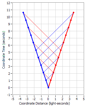

Moreover the fact that if we were to be in a reference frame with B at rest B would observe A's clock going slow leads to a kind of paradox in that each spaceships sees the others clock going slow. I can make sense of this apparent paradox by applying my above logic in that the spaceships are only perceiving the others clocks to be slow, where in actuality both clocks keep the same time for observers looking at their own clock.
If I'm talking rubbish can you please explain why and what you think I am misunderstanding? And also how to explain the apparent paradox in that each spaceship sees the other clock going slow.

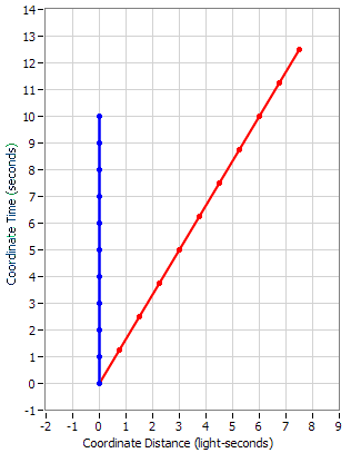

Imagine a scenario in which there are 2 spaceships A and B. Each spaceship has its own clock. Spaceship B moves a uniform speed, v, past A. When A and B are exactly adjacent the clocks are synchronized to read the same times.
I think the best way to understand scenarios like yours is through spacetime diagrams. Here's one that depicts your scenario from the moment that spaceship B (depicted in red) passes spaceship A (in blue) and they synchronize their clocks. Spaceship B is traveling at 0.6c. The one-second ticks of their clocks are shown as dots. Since A is stationary in this frame, his clock ticks at the same rate as the Coordinate Time. Since B is moving at 0.6c, we can calculate his Time Dilation as gamma which equals 1.25. You can see that his dots are spaced 1.25 times the Coordinate Time:

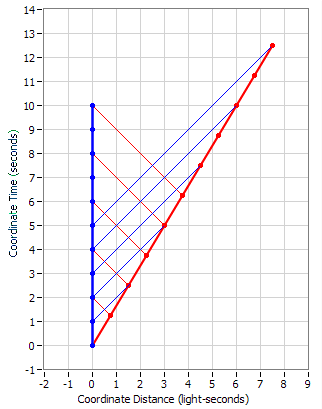

Now considering the reference frame in which A is stationary. B will move away from A and A will thus observe B's clock going slow due to time dilation.
Not just Time Dilation but Time Dilation plus the time it takes for the images of the clock's ticking to traverse the ever increasing distance from B's clock to A. This is known as Relativistic Doppler and it has a different formula than Time Dilation. For a clock moving away at 0.6c it evaluates to 0.5. That is, A sees B's clock ticking at one half the rate of his own and B sees A's clock ticking also at one half the rate of his own. We can add the images of each clock ticking traveling at the speed of light between the two clocks:

Both A and B have the same perception of the other ones clock. They each perceive their own clock to be ticking normally and the other ones clock to be ticking at half the rate of their own. Neither one of them can perceive any Time Dilation, either in their own clock or in the other ones clock.

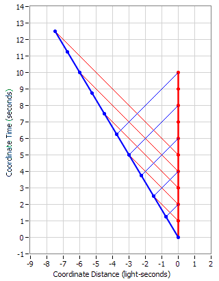

There's no paradox. We can transform from the rest frame of A to the rest frame of B using the Lorentz Transformation process:
Now it's spaceship A's clock that is Time Dilated while spaceship B's clock ticks at the same rate as the Coordinate Time but both continue to perceive the other ones clock ticking at one half the rate of their own. It's important to realize that both these diagrams contain exactly the same information. Neither one is better or more important or more real than the other. You might think that A's rest frame is better for A and B's is better for B, but that is not even true. Both depict equally what each one perceives. In fact, we can also transform to a frame in which both spaceships are moving at the same speed in opposite directions, this speed being 0.3333c:
Again, you can see that both spaceships perceive the other ones clock to be ticking at one half the rate of their own, even though, in this frame they are Time Dilated to the same extent (1.06) and ticking at the same rate.
I hope this helps you understand what Time Dilation is and how it is different from Relativistic Doppler and how it is the later that determines perception and not the former.

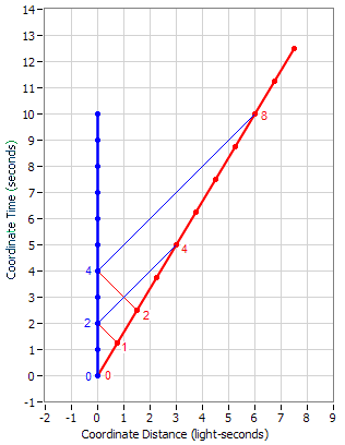

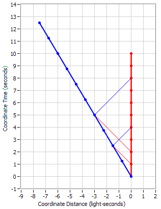

But what if he couldn't see the time on A's clock? Let's just suppose that something happened at A's time of 2 and something else happened at A's time of 4. B can still measure the time interval according to his rest frame by continually sending out radar signals noting the times they were sent and the times the echoes were received according to his own clock and then noting the pairs of times corresponding to reflections off the two events of interest. Then after doing some calculation, he can determine the correct time interval.
Here is a spacetime diagram for the rest frame of A showing just the radar signals and their reflections that happen to hit the two events of interest:
For the first radar, B has logged a sent time of 1 second and a received time of 4 seconds. He averages these two signals to get 2.5 seconds and sets that as the Coordinate Time of the first event. Similarly, for the second radar, B has logged a sent time of 2 seconds and a received time of 8 seconds for an average of 5 seconds and sets that as the Coordinate Time of the second event. Taking the difference, he establishes that the time interval between those two events is 2.5 seconds according to his rest frame.
The reason this works is because he is applying Einstein's second postulate for his rest frame when he averages the sent and received times. He is assuming that the radar signal took the same time to get to the target as the reflection took to get back to him even though it isn't true in the frame we were viewing this in.
But it is true in his own rest frame as you can see here:
