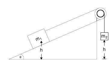

A double pulley consists of two separate pieces that are welded together; a hoop of radius 10.0 cm and a disk of radius 25.0 cm. The moment of inertia of the pulley is 0.160 kg-m^2. A 15.0 kg block (m1), on a 35.0° incline, is attached to the outer pulley by a massless cable and a 24.0 kg block (m2) is hanging from the inner pulley by a massless cable. The incline has a kinetic coefficient of friction of 0.250. At the instant shown in the diagram, the two blocks are at a height of 1.50 m and are moving in the appropriate direction with m2 having a speed of 0.240 m/s. The motion is considered complete when either m 1 reaches the bottom of the incline or just before m2 hits the ground.
Use force methods to answer the following questions.
a) What direction are the blocks moving and why?
b) How far will each block travel in their respective directions?
c) Find the angular acceleration of the pulley?
d) Find the acceleration of block m1.
e) Find the acceleration of block m2.
f) Find the tension in cable 1.
g) Find the tension in cable 2.
So far I think I have found the acceleration of m2, which would indicate that it is moving downward and thus pulling m1 up the ramp. Using this formula, and also factoring in friction, I got 3.1 for the acceleration.
a = ( m2*g - m1*g*sin(θ) - μk*m1*g*cos(θ) ) / ( m1 + m2 )
a = ((24.0*9.81)-(15.0*9.81*sin(35°))-(0.25*15*9.81*cos(35°)))/39.0
a= 3.1
But does that actually mean m2 is pulling m1? Does the double pulley affect this at all?
Overall I am pretty confused how the double pulley plays into this. The only problem I could find that was remotely similar to this was this one, but I still don't understand the difference between a regular pulley and double pulley here.
As for b), I think the final position of m1 would be calculated with:
xf = (2/k)[m2g - m1*g*sin(θ) - μk*m1*g*cos(θ)]
So I could take xf - xi and find the distance traveled. But if I understand correctly that would be using energy, and I need to solve this with force methods.
I also imagine the radii will affect the distance traveled, though I don't what equation to use.
Guidance on double pulleys and determining distance-traveled greatly appreciated!

According to the description in the problem, the double pulley consists of two concentric pulleys that turn together. This implies that each weight has its own cable, and those cables are not connected to each other, but only interact through the pulley. And this implies that a single turn of the pulley will cause the weights to move different distances and at different speeds. Both parts of the pulley will have the same angular speed, however.

You completely ignored the moment of inertia of the pulley. Neither you took into account that the pulley have an inner and an outer radius. The formula you used was invalid for this case. Draw the free-body diagram for both blocks and also on the pulley. Write the equations for the accelerations of the blocks and the angular acceleration for the pulley.
Note that it is the tension of the string that pulls up m1 (not m2) .

Also, I am now factoring in the moment of inertia and the radii. For the acceleration of m1 I am now getting:
a1 = ( (m2 * g * r / R) - (μ * m1 * g * cos(θ)) - (m1 * g * sin(θ)) ) / ( m1 + (m2 * (I/R)^2) + (I/R^2) )
a1 = -1.35
Where r and R are the little and big radii.
a1 is negative. What does that mean?
For distance-traveled I believe the distance of m2 is h, and m1 is h/sin(θ). Is this correct?
How did you get that formula for a1? Explain!
Start up from F=m1 a1. What forces act on m1?

Here's how I did it:
Equations of motion:
m1 * a1 = T1 - (μ * m1 * g * cos(θ)) - (m1 * g * sin(θ))
m2 * a2 = m2 * g - T2
I * α = T2 * r - T1 * R
Deduced from equations:
α = a1 / R = a2 / r
Sub a2 with (a1 * r / R):
m2 * a1 * r / R = m2 * g - T2
Sub α with (a1 / R):
I * a1 / R = T2 * r - T1 * R
Rearrange equation to solve for T2:
T2 = m2 * g - m2 * a1 * r / R
Rearrange 3rd equation to put T1 on left:
T1 = (T2 * r / R) - (I * a1 / R^2)
Sub T2 with the equation from 2 steps above:
T1 = ( (m2 * g) - (m2 * a1 * r / R) ) * (r / R) - ( I * a1 / R^2 )
Multiply out:
T1 = (m2 * g * r / R) - (m2 * a1 * (r / R)^2) - ( I * a1 / R^2 )
Plug in T1:
m1 * a1 = (m2 * g * r / R) - (m2 * a1 * (r / R)^2) - ( I * a1 / R^2 ) - (μ * m1 * g * cos(θ)) - (m1 * g * sin(θ))
Do the algebra for a1:
a1 * (m1 + m2 * (I / R)^2 + (I / R^2)) = (m2 * g * r / R) - (μ * m1 * g * cos(θ)) - (m1 * g * sin(θ))
a1 = (m2 * g * r / R) - (μ * m1 * g * cos(θ)) - (m1 * g * sin(θ)) / (m1 + m2 * (I / R)^2 + (I / R^2))

You made a mistake at the end (in red), It should be (r/R)2
The derivation is much shorter, if you eliminate the tensions by multiplying the first equation by R, the second one by r and substitute for RT1 and rT2 into the second. Express the accelerations by the angular acceleration, and solve for it.

You assumed that m2 moves downward and you got a=-1.08 m/s^2. That means accelerating upward.
If you tried to assume acceleration in the opposite direction, you would get some negative value again. That means, the blocks can not start moving from rest.
In case they move they would decelerate. But the problem asks the direction of motion, which can not be determined from the given data. Either you made some mistake when copying the data of the problem writer gave wrong data.

You eliminated Iα instead of T1 and T2.
[tex]m_1a_1=T_1-m_1g(\sinθ+μ\cosθ)[/tex]
[tex]m_2a_2=m_2g-T_2[/tex]
[tex]rT_2-RT_1=αI[/tex]
a1=αR, a2=αR and isolate the tensions.
[tex]T_1=m_1αR+m_1g(\sinθ+μ\cosθ)[/tex]
[tex]T_2=m_2(g-αr)[/tex]
Multiply T1 by R and T2 by r, substitute into the torque equation.
[tex]rm_2(g-αr)-R(m_1αR+m_1g(\sinθ+μ\cosθ))=Iα[/tex]
Expand, collect the terms with α.
[tex]rm_2g-Rm_1g(\sinθ+μ\cosθ)=α(I+m_1R^2+m_2r^2)[/tex]
[tex]α=\frac{g(rm_2-Rm_1(\sinθ+μ\cosθ))}{I+m_1R^2+m_2r^2}[/tex]Your numerical result was correct, it is negative. The problem is wrong somehow. Ask your professor.

We can not find out the direction of the motion. The blocks would not move without setting them moving . And you can not know if m2 moved initially downward or upward.

Alright, got an email from my professor. Apparently there was an error in the problem. The radius of the larger pulley is now 15cm instead of 25cm.
[tex]α=\frac{9.81*(0.1*24-0.15*10*(\sin35°+0.25\cos35°))}{0.16+10*0.15^2+24*0.1^2}=19.3446[/tex]
And using 0.15 instead of 0.25:
[tex]a_1=\frac{m_2*g*r/R-μ*m_1*g*\cosθ-m_1*g*\sinθ}{m_1+m_2*(r/R)^2+I/R^2}[/tex]
[tex]a_1=2.9016[/tex]
Positive!
ehild said "You assumed that m2 moves downward and you got a=-1.08 m/s^2. That means accelerating upward." So because my acceleration is now positive, that means accelerating downward. Which means m2 is moving downward. Which means m1 is moving up the ramp. Is this logic correct?
Yes.
In the problem text, m1=15 kg. You calculated with 10 kg. Why?
Remember, a1=Rα. You do not need to do all the calculation again.
bjorn_v said:
Positive!
that is correct.
Everybody can make mistakes, even your professor. But he noticed his error and emailed to the students, so all is good. You have learned even form that mistake.
ehild
Likes 1 person
:eek: Close one!
[tex]a_1=1.29[/tex]
[tex]α=8.63[/tex]
bjorn_v said:
:eek: Close one!
[tex]a_1=1.29[/tex]
[tex]α=8.63[/tex]
Much better :smile:. Go ahead.
