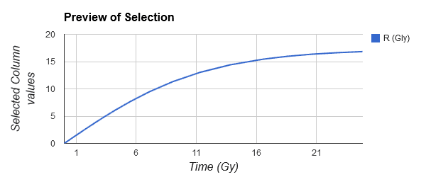

the graph of t and r looks like a logistic equation.

Ledsnyder said:
The graph of t vs r looks like a logistic equation.
[tex]N_{t} = \frac{K}{1 + \frac{K-N_0}{N_0} e^{-rt}}[/tex] (equation 1.1)

What you said is true if we look coarsely over a large time range, especially into the future. For most of your curve, Lambda is totally dominant, giving exponential expansion. If you would limit the time to say 25 Gy or so (try setting S_lower to 0.4 or so), you may find the correlation is not so good, because matter en radiation then prevent an exponential law being followed.
##N_{t} = \frac{K}{1 + \frac{K-N_0}{N_0} e^{-rt}}## (equation 1.1)
Yes, for large arguments, these two expressions have the same functional form.
$$\begin{align}
\tanh T &= \frac{\sinh T}{\cosh T} \\
&= \frac{e^T - e^{-T}}{e^T + e^{-T}} \\
&= \frac{e^{-T}\left(e^T - e^{-T}\right)}{e^{-T}\left(e^T + e^{-T}\right)} \\
&= \frac{1 - e^{-2T}}{1 + e^{-2T}} \\
&= \frac{1}{1 + e^{-2T}} - \frac{e^{-2T}}{1 + e^{-2T}}.
\end{align}$$
For large ##T##, the second term is negligible.
