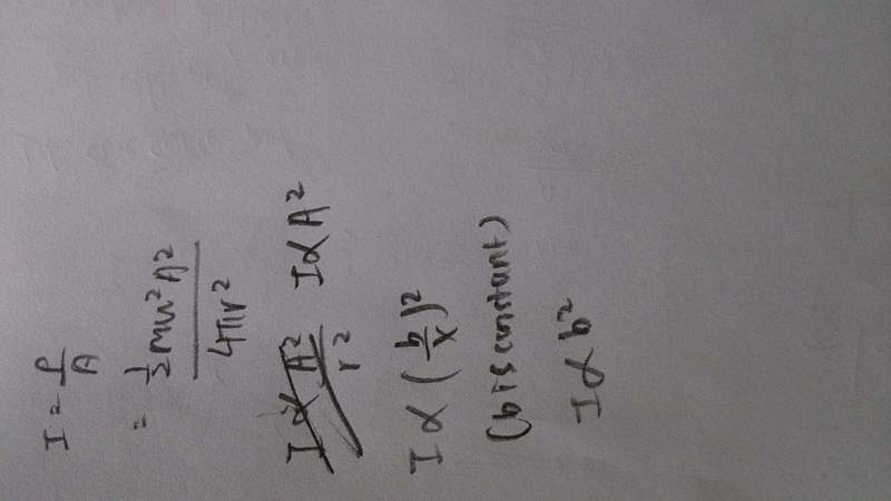

since we know that the intensity of wave is I=P/A P =power, A=area
so I = 0.5m(w^2)(y^2)/4pi (x^2 )
so i got I is directly propotional to (y^2)/ (x^2 )
but there's variable x in the eqaution of y...

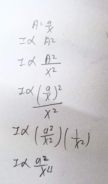

so can i say that I is directly propotional to y^2 / x^4 as in the third photo?
p/s : in here y also represnt A .

The problem statement (attachment 1) suggests maybe a longitudinal wave (oscillations in the x direction) propagating in the +x direction with equation:
##y=\frac{a}{x}\sin(\omega t -kx)## ... so the amplitude falls off with distance.
You are asked to determine how the intensity of the wave falls off with distance.

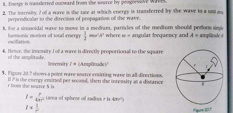

You have a model answer (attachment 2) which says $$I\propto\frac{1}{x^2}$$
i.e. your own $$I\propto \frac{y^2}{x^4}$$ is incorrect.
It is a serious mistake to use y to also be A ... you have to be consistent with your notation.
A, in your post, is area. The model answer uses to to mean amplitude, as in ##y=A\sin(\omega t - kx)##
The question is checking that you know that intensity is proportional to the square amplitude of the wave.

... you mean in the attachment <looks> I see.
The calculation in the attachment is not general.
The wave in that example is spherical. In the problem in post #1 above, the wave is not spherical.

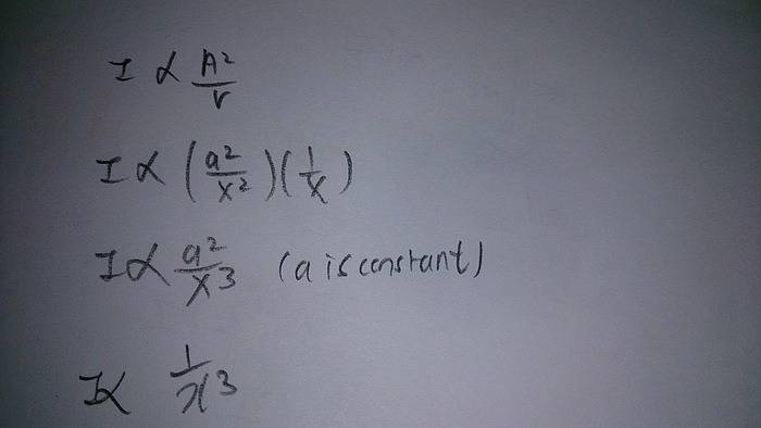

well, you said the wave is not spherical, so it is circular? , so I = P/2∏r , so i would get I is directly propotional to (a^2 )/ (x^3 )... since i is directly propotional to a^2 / r

I = P/2∏r (for circular waves) , so i would get I is directly propotional to (a^2 )/ (r^3 )... since I is directly propotional to a^2 / r but the amplitude = (a/x )

No. That is not logical:
You have
(1) ##I \propto A^2##
(2) ##A=a/x## : "a" is a constant.
(2) → (1): ##I \propto 1/x^2##
This is just normal algebra.

i know that intensity of waves = P/2∏r (for circular waves) , where power = 0.5m(w^2)(A^2)s^-1 , after substituiting the P inside , i have I = 0.5m(w^2)(A^2)s^-1 /2 pi r.
the amplitude is a or a/x ?
so i can say that I is directly proportional to (A^2)/r .
but in the question, the solution gives I is directly proportional to (A^2) but not I is directly proportional to (A^2)/r .
Taking I is directly proportional to (A^2)/r ,
provided a (amplitude ) is constant, so i have I is directly proportional to 1/x as in the working

well why ##I \propto A^2## not ##I \propto A^2/x## ?
since intensity = power / 2 pi r ...
