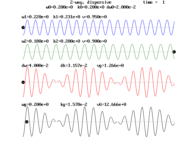

In summary, the conversation discusses the topic of group velocity and the various simulations that were attempted to better understand it. The first simulation showed sensible results, but subsequent ones led to unexplained results. Possible explanations were discussed, including the direction of the phase wave velocity and the concept of a pattern shift. The conversation also mentions the possibility of using PF as a backup for personal reference and cross-referencing with others. Finally, the conversation delves into the equations used in the simulations and how the frequency and wave number may need to be assigned different signs.
mysearch
526
On first reading, the description of ‘group velocity [vg]’ appears to be quite straightforward. However, I also found a number of speculative explanations as to ‘how’ and ‘why’ the group velocity may exceed the ‘phase velocity [vp]’. Therefore, in order to get a better intuitive understanding of the issues, I am ‘attempting’ to simulate 4 different types of beat wave configurations:

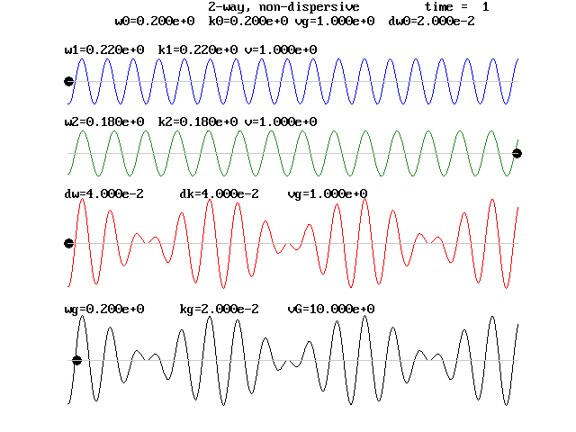

  • 1-way, non-dispersive phase waves
  • 2-way, non-dispersive phase waves – see 2ND.gif attachment
  • 1-way, dispersive phase waves
  • 2-way, dispersive phase waves – see 2D.gif attachment
Each simulation uses the same basic approach in which the amplitude of two individual phase waves is added, and calculated, for all values of [x], which is then displayed as a single frame in the animation. The process is then repeated for incrementing values of time [t] to create the next frame within the animation. While the first simulation in the list above produced ‘sensible’ results, i.e. [vg=vp], all the subsequent permutations, based on the same algorithms, lead to ‘unexplained’ results. For example, the second simulation changes only the direction of one of the phase waves, but appears to suggest a group velocity that is 10x the phase velocity, although the actual value calculated was [vg=1]. My initial lines of thoughts:
  • There is an mistake in the simulation. If so, it is not obvious to me, but see next bullets.
  • The equation used to calculate [vg=dw/dk] might have to accommodate the direction of the phase wave velocity [vp]. For example, given that [vp=w/k], such that [k=w/vp], then treating [vp] as a vector having magnitude and direction might suggest that the sign of [k] must also be direction dependent. However, it is unclear whether this would explain the anomalous result associated with the 1-way simulations.
  • The equation [vg=dw/dk] would be greater than [vp], when [dw>dk], which appears possible in dispersive media – see equation [1] in attached pdf for details. However, it is not clear this would explain the non-dispersive cases.
  • The simulations are only showing an 'pattern shift'. For example, when the phase waves propagate with velocity [c] in opposite directions, the phase relationship between these waves constantly changes with time, i.e. on every frame. So while the ‘shift’ in the beat waveform might suggest a propagation velocity greater than [c], it has nothing to do with anything propagating through the media, rather it simply reflects the rate of change in phase shift between the phase waves.
I have attached ‘simulations.pdf’ in order to give some more details of the simulation results for anybody who might be interested in this topic. I have also attempted to attach two gif files to give ‘examples’ of the animations, although the upload size required 500 frames to be reduced to just 25 and so are they very jerky.
Anyway, I would appreciate any help on offer as I am sure somebody must have already resolve these issues. Thanks

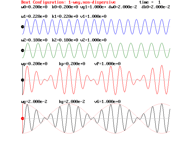

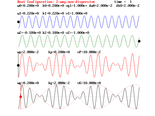

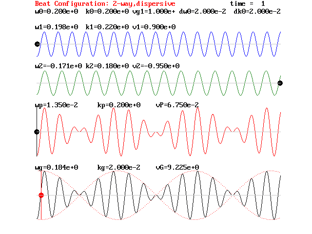

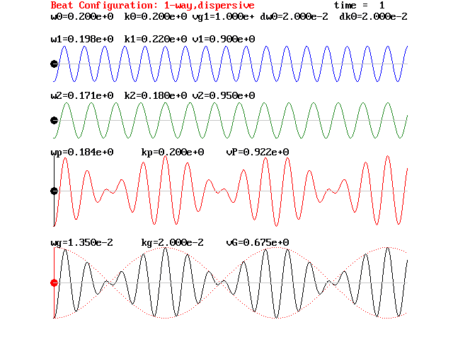

Anyway, I have attached some updated animations, which now show the relative phase and group velocity on the beat waves, see bottom two red and black waveforms, for the following configurations.
Given the upload limit I have restricted the animation to the first 50 frames of 500. Despite the reservations above, these animations seem to make sense, but maybe I am still missing some explanation of the issue above. Anyway, as indicated, the information posted might help somebody at a later time.

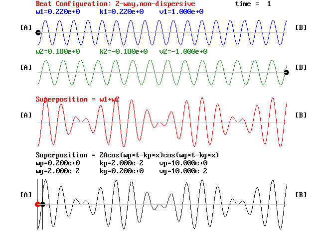

Again, I do not disagree with your reasoning, but my simulation results gave up 2 conflicting sets of results depending on whether using [w=v*k], which worked, as opposed to [k=w/v], which didn’t. The following equations are used in both cases below, but seem to give up different results based on the sign of ##[ \omega ] ## or [k] - see results below as an example of the 2-way non-dispersive case using both approaches.
[itex] ω_p = \dfrac{ω_1 + ω_2}{2}; k_p = \dfrac{k_1 + k_2}{2}; v_p = \dfrac{ω_p}{k_p}[/itex]
[itex] ω_g = \dfrac{ω_1 - ω_2}{2}; k_g = \dfrac{k_1 - k_2}{2}; v_g = \dfrac{ω_g}{k_g}[/itex]

In both cases the analysis shows that you have a product of two waves, a short wave with ##k = 0.2, w = 0.02, v = 0.1## and a long wave ##k= 0.02, w = 0.2, v = 10##. The only difference I can see is which wave you call ##g## and which wave you call ##p##. Maybe I'm missing something.
Apologises if my rushed outline in post #6 was confusing. In an attempt to provide some greater clarity to the issue I am trying to resolve, I have attached a pdf file to this post that provides more detail. Some limited animations produced by the simulation are attached to post #4 with 2.gif showing the specific case detailed in the pdf file. While it is realized that nobody may be interested in working through all this detail, should anybody be able to resolve the apparent anomaly, it would be appreciated if they could let me know via the PF forum. Many thanks.
  • Beats.pdf
In your pdf you mention several times that you apply your values to 2 sets of equations and get different values of ##v_p## and ##v_g##. The 2 sets of equations describe different situations, so they should get different values.
You have to choose either
a) a single equation and signed ##k## (or ##\omega##), to signify the direction of propagation, or
b) or two different equations depending on propagation direction and unsigned ##k, \omega##.
Also, you mention at the top of page 2 that both values appear to be wrong. Just looking at your simulation #2, it seems consistent with what I said in post #7, which is that you have a wave with ##k=0.2, v=\text{small}##, modulated by a wave with ##k=0.02, v=10##. What you've computed in the box is indeed choice a) above: using the single equation ##\cos(\omega_1 t - k_1 x) + \cos(\omega_2 t - k_2 x)## with a signed ##k_2##, and you seem to have the correct result for when the ##k=0.18## wave is propagating to the left.
Finally, the choice of the form ##\cos(\omega t\pm\ kx)## vs. the form ##\cos(kx \pm \omega t)## makes no difference at all because
$$\cos(\omega t- \ kx) = \cos(-(\omega t - \ kx)) = \cos(kx - \omega t).$$
Again, appreciate the feedback as it is making me review all my assumptions. Some initial thoughts in a somewhat random order:

When I first did the derivation of the superposition beat equation, i.e.
[1] [itex]A=2 A_0 cos( \omega_p t – k_p x) cos( \omega_g t – k_g x)[/itex]
I started from the form [wt-kx] for the reasons explained above:
[2] [itex]A=A_0 [cos( \omega_1 t – k_1 x) + cos( \omega_2 t – k_2 x) ][/itex]
However, it seemed equally valid to start from
[3] [itex]A=A_0 [cos( \omega_1 t – k_1 x) + cos( \omega_2 t + k_2 x) ][/itex]
Although the derivations based on [2] or [3] both lead to [1], the definitions of [kp,kg] changes in sign depending on whether [2] or [3] is used. In-line with your advice in (a), the simulation has tried to use only the equations from one derivation, i.e. as derived from [2], where it was assumed that changing the sign of [k] would change the direction of the second plane wave [w2, -k2], which it does. The results I previously gave for the second option based on [3] were erroneous as they end up only reflecting the waves propagating in the same direction. However, based on option a) and [ (## \pm ## k) = w/(##\pm## v)], the following equations were assumed to reflect the values of [wp,kp] and [wg,kg] when [-k2] reflects the second wave propagating in the opposite direction:
[itex] ω_p = \dfrac{ω_1 + ω_2}{2}; k_p = \dfrac{k_1 + (-k_2)}{2}; v_p = \dfrac{ω_p}{k_p}[/itex]
[itex] ω_g = \dfrac{ω_1 - ω_2}{2}; k_g = \dfrac{k_1 – (-k_2)}{2}; v_g = \dfrac{ω_g}{k_g}[/itex]
As stated, this did not seem to provide consistent results. However, when I changed the sign dependency to [w], not [k], i.e. [(##\pm## w)=(##\pm##v)*k] everything appears to work and I believe I can physically explain the values of [vp] and [vg], see my quote below, but not necessarily [ ##\pm##w].
For the reasons I think we both agree, the simulation should be consistent, i.e. based on ‘choice a)’. However, I do not believe any of the simulation results on page 2 are right, when the direction of the second plane wave was defined by [-k]. Only the configuration based on [ (##\pm##w) = (##\pm##v)*k] at the bottom on page 2 and the results on page 3 appear consistent with my interpretation of the beat superposition, i.e.
“In this specific non-dispersive case, where [v1=+1, v2=-1], the rationale for [vp=0.1] can be explained as being analogous to a standing superposition waves. For as [Δω] approaches zero, the phase velocity of the superposition wave, i.e. the higher frequency component of the beat waveform must also approach zero. While a group velocity [vg>1] appears anomalous, it is argued that the group wave envelope is not actually propagating through space-time, as it more accurately reflects the phase shift between waves-1 and wave-2 occurring at all value of [x] simultaneously in time [t]. This phase shift effect, leading to the perception of [vg>1] is higher when wave-1 and wave-1 propagate in opposite directions. However, while now having to argue for the results above, it is still unclear why these equations require the directional [±] sign to be assigned to [ω] not [k].”​
So while I have always had a simulation that works, based on option a), my main issue is that I cannot physically explain why the sign of second plane wave [w2, k2] has to be assigned to [w2] not [k2] to get the correct values of [vp] and [vg]. Maybe there is another [##\pm##] I am missing - I will keep checking but I have possibly become 'snow-blind' by looking at these equations for too long:rolleyes:, which is why a second pair of 'fresh eyes' is helpful. Thanks
mysearch said:
I do not disagree with the mathematically equivalence of the cosine functions shown. However, in isolation of the cosine, (wt-kx) is not equivalent to (kx-wt); especially when considered from the physical interpretation of a propagating wave. This, in part, was one of the points initially raised because the simulation only considers incrementing time [t]. If frequency [w] is always a positive, then [wt] must always be positive in the cases being considered. Therefore, [wt ## \pm ## kx] was assumed to be the appropriate starting point.
I guess I still don't understand why there's any difference in physical interpretation.
##\cos(kx-\omega t) = \cos\left(k\left(x-\dfrac{\omega}{k}t \right)\right)## is a (spatial) waveform with shape ##\cos(kx)## which is translating to the right at speed ##\omega/k## per unit time.
##\cos(\omega t - kx) = \cos \left(\omega\left(t - \dfrac{k}{\omega} x\right)\right)## is a (time) oscillation ##\cos(\omega t)## that is translating forward in time at ##\dfrac{k}{\omega}## per unit distance.
By mathematical equality,
##\cos(\omega t - kx) = \cos(-kx + \omega t) = \cos \left(-k\left(x - \dfrac{\omega}{k} t\right)\right) = \cos \left( k \left(x - \dfrac{\omega}{k} t \right)\right)##, which is exactly a wave ##\cos(kx)## that is translating to the right at speed ##\omega/k##.
On this basis, it was assumed that [ (## \pm ## k) = w/(## \pm ## v) ] not [ (## \pm ## w) = (## \pm ## v)*k ], although this appeared to lead to problems when calculating [wp,kp] and [wg,kg] as I tried to illustrate.
You don't need to carry the ##\pm## signs everywhere. You just pick a convention, and then the signs work out.
Look at ##A(x, t) = \cos(\omega t - kx)##: when ##\omega## and ##k## are both positive, then ##v = \omega/k## is also positive, so you have rightward phase propagation. If ##\omega## and ##k## have different signs, then you will have leftward phase propagation. If you decide that ##\omega## is always positive, then the sign of ##k## is enough to know whether the wave is propagating to the right or the left.
As they should. In [3] the second wave is ##\cos( \omega_2 t + k_2 x) = \cos\left( k_2 x - \left(-\dfrac{\omega_2}{k_2}t \right)\right)##. This means that for ##\omega_2, k_2## both positive, the second wave is propagating to the left at ##\omega_2/k_2##. This approach is fine, but then you have to use different equations for different combinations of propagation directions.
However, when you use [3], you don't "double-count" the propagation direction by also using a negative ##k_2##. You use ##k_1, k_2## both positive and the leftward propagation is built into the equation.
So for example, on your page 2 in the box under
$$\cos(\omega_1 t - k_1 x) + cos(\omega_2 t + k_2 x)$$

Well, it took me a bit longer than it should have, but I have finally worked through the permutations, which explains the reversal of the ##p## and ##g## and why this notation can be misleading in terms of the phase and group waves, when the waves propagate in opposite directions. For when deriving the following equations, it was not obvious, at least to me, that reversing the sign of [##k_2##] would cause the inference of ##p## and ##g## to also be reversed in terms of phase and group, as few references seem to cover this point:
[2] [itex] \omega _p = \dfrac{\omega _1 + ω_2}{2}; k_p = \dfrac{k_1 + k_2}{2}; v_p = \dfrac{\omega _p}{k_p}[/itex]
[3] [itex] \omega_g = \dfrac{\omega _1 - ω_2}{2}; k_g = \dfrac{k_1 – k_2}{2}; v_g = \dfrac{\omega _g}{k_g}[/itex]
Purely, by way of reference should anybody else come down this road, the attached file shows the results when [##\omega=v*k##], which works for all values of [ ##\pm v##], and [##k=\omega/v##], which works for [##v_1=v_2##] but not [##v_1=-v_2##]. It is also highlighted that the normal definition of [##v_g=\Delta \omega / \Delta k##] looks suspect when [##v_2##] is negative and [##k=\omega /v##], but maybe this definition doesn't support the inclusion of direction? Anyway, splitting the definition of [1] into its two components:
[4] [itex]A=2 A_0 cos( \omega_p t – k_p x)[/itex]
[5] [itex]A=2 A_0 cos( \omega_g t – k_g x)[/itex]
Based on the argument that [##k=ω/v##], then [4] does describe the phase wave and [5] the group wave, but only when [##v_1=v_2##]. If [##v_1=-v_2##], then the descriptions are reversed, such that [4] now describes the group waves and [5] the phase wave. However, if you ignore the physical implications of negative time and allow [## \omega=v*k##], then [4] describes the phase wave and [5] the group wave, irrespective of the value of [##\pm v##]. In part, because this last approach worked and the notation the ##p## and ##g## suggested phase and group, I didn’t think that just changing the sign of [##k_2##] would change the definition as described, but it does when you sit down and work through the numbers.
While the initial response to this thread didn’t look too promising, I really appreciate the time and effort in helping me resolve the problems I was having with the simulations. While I should really leave matters here, there was one other issue that was touched on throughout this thread, which was summarised in post #13:

Hi,
I originally raised some questions in this thread last year regarding phase and group velocity, but wanted to return to the subject in order to try to resolve any ‘physical’ interpretation associated with these velocities. In part, my issue relates to the maths and interpretation linked to the simulation attached. This simulation attempts to shows two waves (blue and green) propagating through a ‘non-dispersive’ medium, such that both waves have equal velocity magnitude [v=1], but different angular velocities [w] and wave numbers [k], but where [w/k=v=1]. Within the simulation, 2 different approaches were used to produce the superposition red and black traces, which takes the shape of a beat waveform. The red trace is produced by simply adding the 2 blue and green waveforms, while the black trace is calculated using the following formula:[itex] A=2 A_0 cos( w_p t – k_p x) cos( w_g t – k_g x) [/itex]The values of [itex] w_p, k_p, v_p [/itex] and [itex]w_g, k_g, v_g[/itex] are determined from the parameters assigned to waves 1 & 2:[itex] w_p = \dfrac{w_1 + w_2}{2}; \quad k_p = \dfrac{k_1 + (\pm k_2)}{2}; \quad v_p = \dfrac{w_p}{k_p} [/itex][itex] w_g = \dfrac{w_1 – w_2}{2}; \quad k_p = \dfrac{k_1 - (\pm k_2)}{2}; \quad v_p = \dfrac{w_p}{k_p} [/itex]
When blue and green waves propagate in the same direction, the sign of [itex]k_1, k_2[/itex] are the same, such that the [itex]\pm[/itex] can be ignored. However, when these waves propagate in opposite directions, as in this specific case, the wave number [k] effectively acts a vector quantity, which reflects the [itex]\pm[/itex] direction of propagation. Hence the following values for the simulation attached.
[itex] w_p = \dfrac{0.22+0.18}{2}=0.2; \quad k_p = \dfrac{0.22 +(-0.18)}{2} = 0.02; \quad v_p = \dfrac{0.2}{0.02} = 10 [/itex]
[itex] w_g = \dfrac{0.22-0.18}{2}=0.02; \quad k_g = \dfrac{0.22 – (-0.18)}{2} = 0.2; \quad v_g = \dfrac{0.02}{0.2} = 0.1 [/itex]
While the red and black outputs are identical, which appears to supports the maths used in both approaches, the values of the phase [itex]v_p[/itex] and group [itex]v_g[/itex] velocities appears difficult to reconcile within the simulation, which is reduced to the first 50 frames. The black dot on both the blue and green traces corresponds to the propagation velocity of these waves, e.g. [v=1]. Superimposed on the bottom black trace is a black and red dot that should correspond to the phase velocity [itex]v_p=10[/itex] and group velocity [itex]v_g=0.1[/itex] respectively. However, the faster black dot appears to tracking the wave packet envelope, which is normally associated with the group velocity, while slower red dot appears to be tracking successive peaks within the underlying phase wave.
Can anybody explain this anomaly?
My initial interpretation is that ‘information’ flowing between [A-B] and [B-A] is physically constrained by [v=1]. As such, any implied ‘superluminal’ inference of [v=10] simply reflects the change in the superposition amplitude at each value of [x] at any instance in time. Therefore, this is not a ‘real’ velocity, but rather a wave pattern that is changing at every position [x] on every tick of the clock. However, I assumed that the group velocity [itex]v_g=0.1[/itex] would have some physical interpretation, i.e. the velocity of the group wave packet, which does appear to be the case, at least, in this simulation. Would be grateful for any knowledgeable insights as to what might be going on. Thanks
P.S. I haven't used the forum in a while. Can you still reverse order the posts within a thread, i.e. latest first? Plus, its seems to take a while for the scrolling within a page to settle down - is this now normal?
