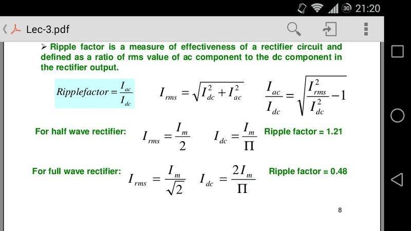

I am stuck up at finding the ripple factor for a half wave rectifier.
According to the formula- V(rms)/Vdc.
But how to find Vrms?
To find it I would require the equation of the half wave rectified sine wave, right? How do I form that?
But for half wave rectifier Vrms=Vpeak x 0.385
How did that come?
This pic shows a different version of the formula
What is the exact difference between Iac and Irms?

The pulsating output of a rectifier consists of DC component and an AC component ( also known as ripple). The AC component is unwanted and accounts for the pulsations in the rectifier output. The efficiency of a rectifier depends upon the magnitude of AC component in the output. The smaller this component, the more effective is the rectifier.
The ratio of rms value of AC component to the DC component in the rectifier output is known as ripple factor
so r ( ripple factor)= Iac/Idc
,I just came by the term ripple factor when I was studying rectifier circuits and then they just mentioned that ripple factor for a half wave rectifier is 1.21, just the value no derivation, nothing.
the image you posted above tells you how the ripple factor of 1.21 was achieved
what part didn't you understand ?Dave

Now if we go by the exact mathematical definition of rms-
Rms value of a function f(t) with period T
Some formula in which we integrate the function with limits 0 to T and take the avg over T
In case of the sine wave of the output half wave rectifier -
We integrate with limits 0 to T/2 and take the avg over T or T/2? because if I use T/2 I get the wrong result.

good - your calculus is probably fresher than mine (1964).
Take average over T not T/2. One whole line cycle. If you use T/2 you haven't accounted for the second half cycle where the function has value zero and your mean will be too high.
And i think you implied integrating the function^2 ?
Well done ! Thanks ! We all love to see "the light go on" .
EDIT
I woke up worried i might've been ambiguous, or wrong...
We only integrate to T/2 because after that the function is no longer a sinewave.
Maybe you're sharp enough to write the equation of a halfwave rectified sine but I'm not.
So we integrate to T/2 accumulating the mean of sin^2 curve for that first half cycle
and realize that mean is spread over twice the period of integration making it half as big
so there's a 1/2 underneath the radical
which puts a √2 into our result
that's why:
RMS output of a full wave rectified sinewave is Vpeak/√2
but a half wave is Vpeak/2
less by only √2 not half. Root comes after Mean.
So T1 to T/2 are limits of integration
but T1-T2 is the interval over which we average.
You said it exactly right.
