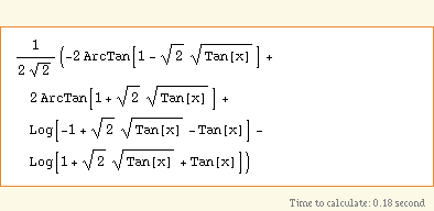

I can't provide any real help to the answer of this integral, but I did do it online and I've attached the answer. It's long, but maybe it will provide some insight.
Jameson

Jameson said:
I can't provide any real help to the answer of this integral, but I did do it online and I've attached the answer. It's long, but maybe it will provide some insight.Jameson
I don't think that's right; I think it should be:
[tex]\frac{-\sqrt{2}(\ln(\vert(\sqrt{2\tan (x)}+1)\cos (x) + \sin (x)\vert)-\ln(\vert(\sqrt{2\tan (x)}-1)\cos (x) - \sin(x)\vert)-2(\tan^{-1}(\sqrt{2\tan (x)}+1)+\tan^{-1}(\sqrt{2\tan(x)}-1)))}{4}[/tex]
I don't think
[tex] I=2\int \frac{t^{2}}{\left(1+\sqrt{2}t+t^{2}\right)\left(1 -\sqrt{2}t+t^{2}\right)} \ dx [/tex]
is consistent with the original integral, because that would be [itex]-\cos^2 x[/itex]
Well, that's what Wolfram's online integrator spat out. I couldn't defend it or not. It looks to be close to where this thread is leading with the partial fractions. Can you show the steps you used to arrive at your answer?

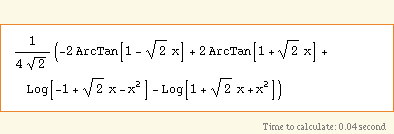

Actually now I'm fairly sure my answer is correct. Using Daniel's substitution and arriving at this...
[tex]2\int \frac{t^{2}}{1+t^{4}}\dt [/tex]
I've attached the answer to this integral, and when you substitute
[tex]t = \sqrt{\tan x}}[/tex]
back into this integral, you yield my original answer.

"-cos^2 x" is [itex] -((\cos (x))^2)[/itex]
I think Daniel was asking where did that come from?
Hmmmm... your probably right.
So where did it come from? How did you arrive at your answer?
Which answer?
I am quite sure that
is [tex] -\cos^2 x [/tex]
I am much less positive about the other answer.
It's posible that
is equivelent to your answer.
