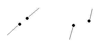

Going back to the original question, if you take a pair of charges at a 45 degree angle, and do a "Loerntz boost", the force between the charges initally obeys both the strong and weak forms of the third law (as per Goldstein's terminology), as the forces are equal, opposite, and on a direct line between the charges.
If you do a "Lorentz boost" to a new frame, the force between the charges satisfies the weak law, but not the strong law. This means that the forces are equal and opposite, but no longer on a direct line between the charges in the frame. (Note that we are talking about the 3-forces here!).
See the attached diagram for how it all turns out.
This gives rise to a rather obscure paradox in special relativity known as the "lever paradox", whereby internal forces contribute to the angular momentum of a system.
