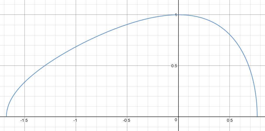

Here's a plot:
The domain of the solution is found from:
\(\displaystyle -\left(2e^x(x-1)+1\right)\ge0\)
\(\displaystyle 2e^x(x-1)+1\le0\)
Using numeric techniques, we find (approximately):
\(\displaystyle -1.6783469900166606534\le x\le0.76803904701346556526\)
