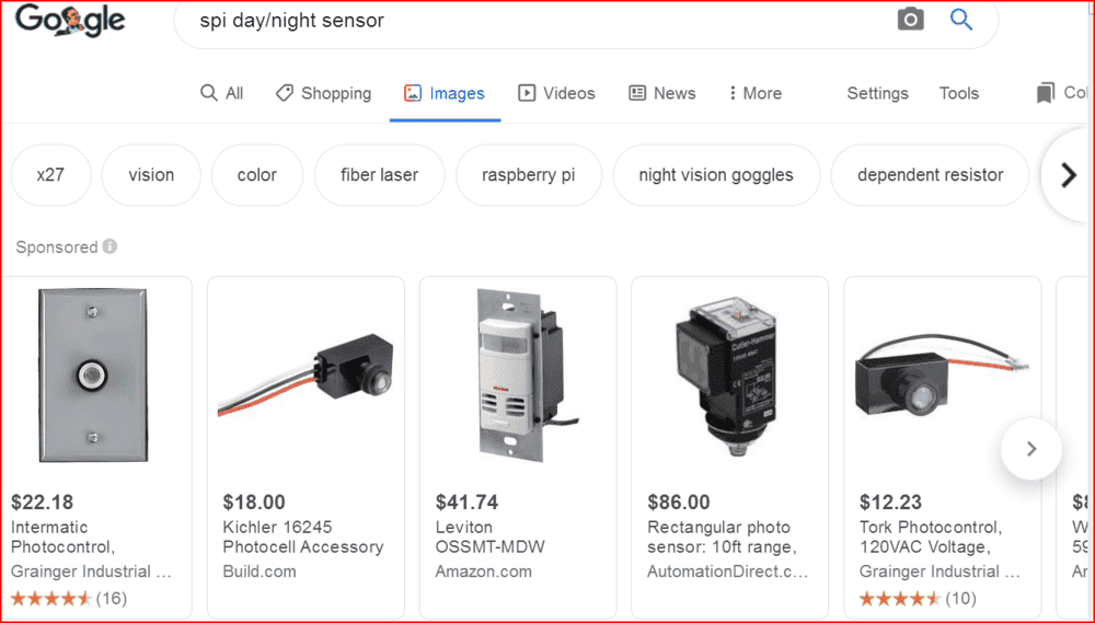

LOL, that's funny! Still, what serial communication standard would you like to use?
Here's a quick Google Images search on SPI Day/Night Sensor:
I wasn't able to find one in the Google-search that has an input of 1.5-volts?

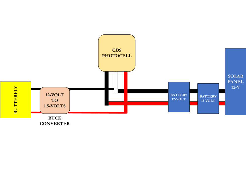

input received… Update(s) applied. Here’s the latest:
Twilight zone. Dee-do-dee-do...
Or maybe I'm just not tracking your thinking here...
Your new diagram shows a solar panel as having an AC voltage output? I must be misinterpreting it, no?
And you show a parallel connection of two 12V lead-acid batteries to provide double the VA rating, but do you understand what that means? What must be true about those two batteries and their histories?
>>> Yeah... I surely desrve it...
>>> I copied this from the website where purchased. Obviously incorrect.
>>>12-volt, 1.5-watt.
>>>Parallel... The two batteries produce the same volts output... Not double? With more output zing! :cool:
>>>The batteries were for an electric-scooter, but sold the scooter before I installed them.
Ah, so the two batteries were meant to be used in parallel in the scooter, or in series. If in parallel, they may be matched well enough for you to use them in another parallel application. If not, they may not be all that well matched. Connecting two batteries with different characteristics (including charging history) can be a bad thing...
So... Got any ideas on how to make the butterfly hibernate at night?

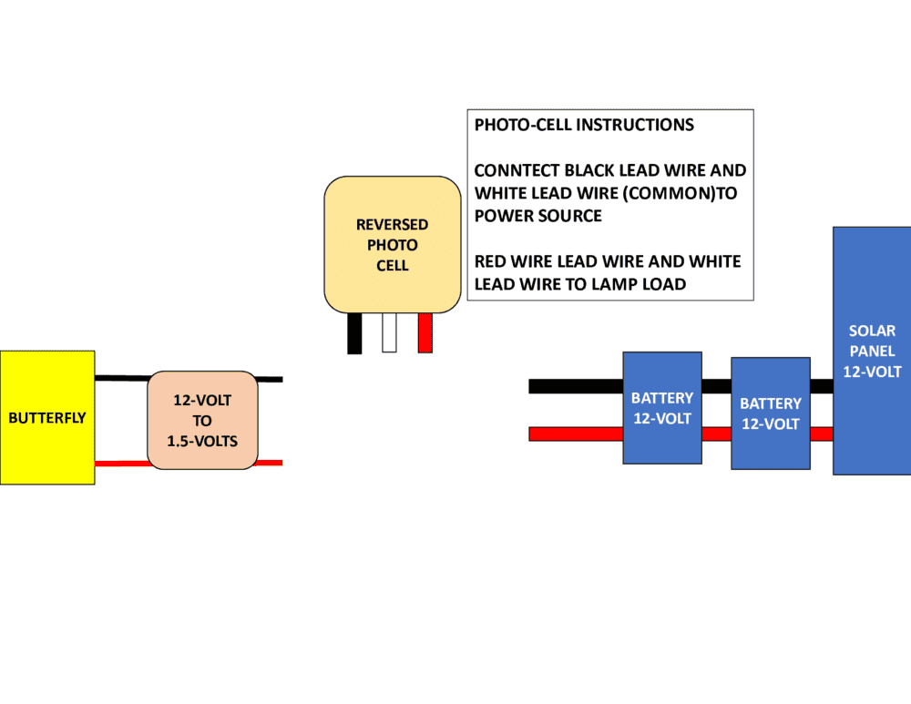

I'm back! I found a reverse photocell. But now I need help on how to connect the wires?
Please send a link to the reversed photo cell.
BoB
Likes Tom.G
I don't know for certain but I would be very skeptical as to whether that will work at 1.5V.
BoB
I was going to connect this to the 12-volt batteries output.
I was hoping to get your advice on how to connect the wires?
Is connecting the wires too simple of a question? Or am I so wrong there is not an answer? :headbang:
If you read the Q&A section on Amazon there are instructions for connecting the switch.
BoB
Understand I don't know leads from loads! :oldconfused:
Gabe G. said:
Red(load) goes to the positive + wire of the light. The white goes to the negative terminal of the battery and the black goes to the positive terminal of the battery. Don't forget to take the negative wire of the light to the negative terminal of the battery as well.
Replace "light" with "voltage regulator"
BoB
Likes CCinPA
Today... I tested without the buck-converter. Although I had 12+-volts into the photocell... No output from the photocell with/without sunlight.
The Black photocell wire should connect to the Battery Positive (+)
The White photocell wire should connect to the Battery Negative (-)
When measuring between the Red and the White wires, the Red photocell wire should switch On (to battery voltage) and Off depending on the light level.
There is a possibility that the unit does not turn on when there is not a light (a load) connected to it. Try connecting a light bulb from a car to it to see if that helps.
Some Amazon reviewers say that it has to be really dark for the unit to turn on.
Some also say they received units that did not work, were marked wrong, or failed in a few days. Perhaps you received a bad one.
