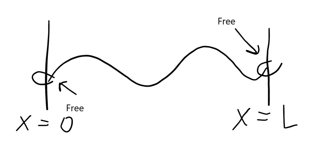

I want to know the conditions in the case of Open-End.
## \frac{1}{v^2} \frac{∂^2y}{{∂t}^2} = \frac{∂^2y}{{∂x}^2} ## and general solution ## y = A sin(kx+ωt)+ B cos(kx+ωt) ##
Try $$\left. \frac{\partial y}{\partial x} \right|_{x=L} =0.$$
Likes Another
242686
if free string both ends. The condition is ##\left. \frac{\partial y}{\partial x} \right|_{x=L} =0.## and ## \left. \frac{\partial y}{\partial x} \right|_{x=0} =0.## ?
Yes.
Likes Another
