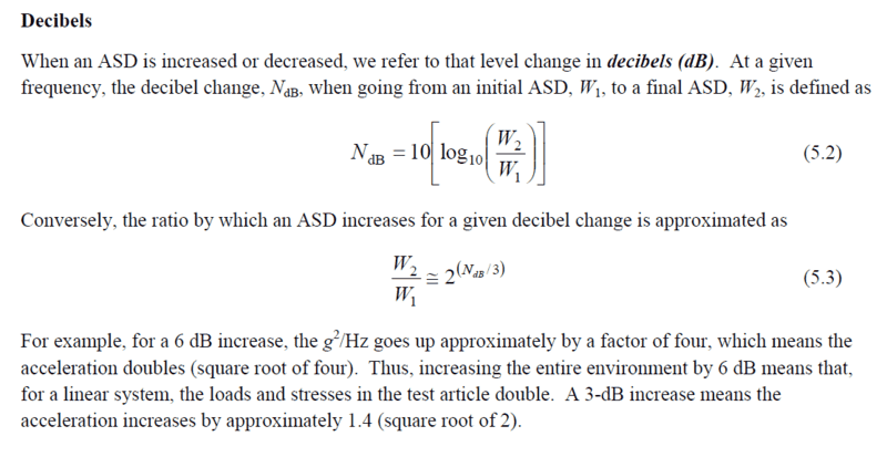

Is there a subjacent reason that explains why these two numbers are so close?
$$10^{1/10} \approx 2^{1/3}$$
For context, this is where I found out about this.
Source: https://www.instarengineering.com/p...ration_Testing_of_Small_Satellites_Part_5.pdf
Is it just a coincidence? I tried factoring the numbers but it doesn't provide any additional information. From the infinite number of possibilities, how did they realize that ##10^{1/10} \approx 2^{1/3}## are so close together that it is acceptable to use the ##2^{1/3}## without losing too much accuracy?

##2^{10}=1024, \sqrt[3] {1024} \approx 10##

How did I not see it? 🤦‍♂️
Thank you. It's clear now.

Pretty much -- ##10^{1/10}## is not all that close to ##2^{1/3}##.
The first is ~1.2599, and the second is ~1.2589. Rounding to 3 decimal places gives 1.260 vs. 1.259. I guess these are close if you consider ##\sqrt 2 \approx 1.4## as they did in the quoted article.
