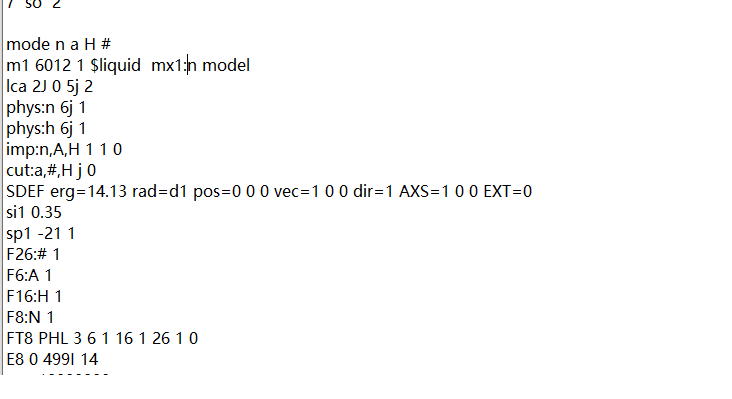

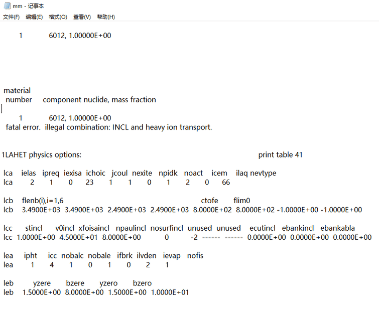

Thank you very much for your answer, but after I modified it according to your prompt, it shows that I used it incorrectly. Is there any problem

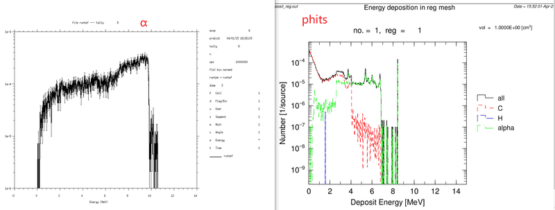

When heavy ion transport is cancelled, the program is ready to run. However, the physical model must also be used, and the α transport results are different from the measured results, but the PHITS results are accurate. Don't know what the problem is

I notice @PSRB191921 said to set phys n and p cards (neutron and photon) and you've set n and h cards (neutron and proton) and I don't know if this is a correction or a mistake.

Thank you very much for your reply. I need to calculate the energy spectrum deposited by alpha particles generated by neutron and C in C. Currently, the program cannot carry out INCL physical model and heavy ion transport at the same time. When I use the physical model of neutron and C alone and make alpha particles deposit energy in the way of INCL, the program can run. However, there is a certain gap between the transport results and PHITS. I don't know what the problem is.
