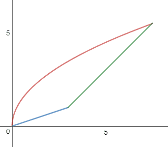

ok so there are 3 peices to this
Express and integral for finding the area of region bounded by:
\begin{align*}\displaystyle
y&=2\sqrt{x}\\
3y&=x\\
y&=x-2
\end{align*}

$3y=x \implies y = \dfrac{x}{3}$
first intersection ...
$x-2 = \dfrac{x}{3} \implies x = 3$
second intersection ...
$x-2 = 2\sqrt{x} \implies x=4+2\sqrt{3}$
$\displaystyle A = \int_0^3 2\sqrt{x} - \dfrac{x}{3} \, dx + \int_3^{4+2\sqrt{3}} 2\sqrt{x} - (x-2) \, dx$

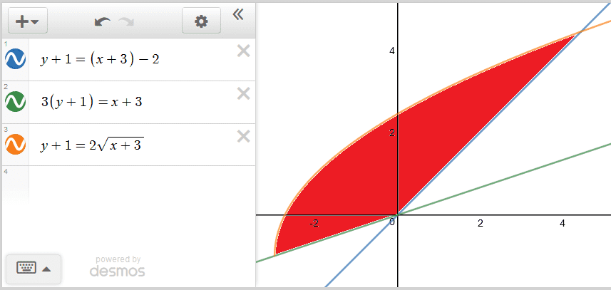

i was courious if this could be iterated into a double integral
Re: 15.3 Express and integral for finding the area of region bounded by:
Yes. First, since we are simply finding the area $A$ bounded by $R$, the integrand will be 1. Using vertical strips, and the work already provided by skeeter, we could write:
\(\displaystyle A=\int_0^3\int_{x-2}^{2\sqrt{x}}\,dy\,dx+\int_3^{4+2\sqrt{3}}\int_{\frac{x}{3}}^{2\sqrt{x}}\,dy\,dx\)
Can you write the intergrals using horizontal strips?
but isn't this still 2 integral sets just added together ??
Yes, but given the nature of the bounded region, there is no way I know of to express it as a single integral without a translation and conversion to polar coordinates.
We could translate everything down 1 unit and 3 units to the left:
Can you determine the limits in polar coordinates?
