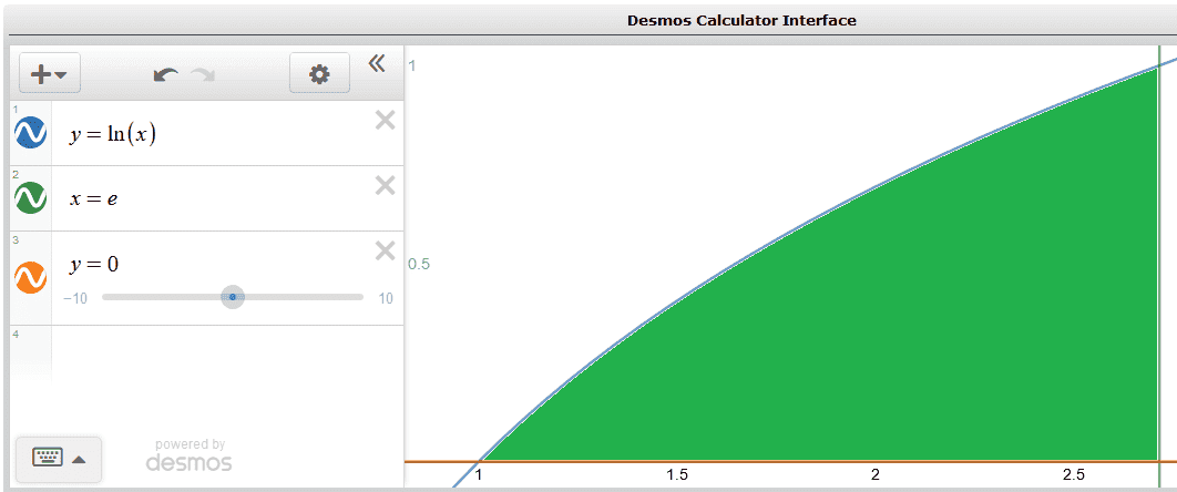

Find the mass and centroid of the following thin plate assuming constant density
Sketch the region corresponding
to the plate and indicate the location
of the center is the mass
The region bounded by
$$y=ln x$$
$$x-axis$$
$$x=e$$

Let's begin by sketching the region making up the lamina:
Okay, now for some constant mass density $\rho$ over this area $A$, we have by definition:
$$\rho=\frac{m}{A}\implies m=\rho A$$
To find $A$, I presume we are to use a double iterated integral. I would use vertical strips:
$$A=\int_{1}^{e}\int_{0}^{\ln(x)}\,dy\,dx=\int_{1}^{e}\ln(x)\,dx$$

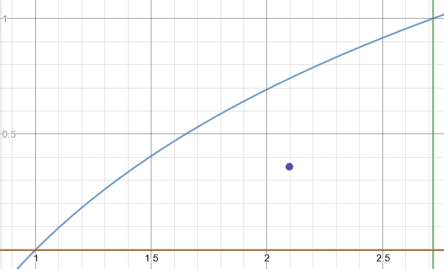

And so the centroid is:
$$\left(\overline{x},\overline{y}\right)=\left(\frac{e^2+1}{4},\frac{e-2}{2}\right)\quad\checkmark$$
mahalo
Awsome help as usual🏄
