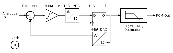

This figure from your link i grasp, from my old control system days..

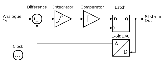

but how does one know in that continuous bitstream pouring out the right end which bit is the beginning of a reading?
This could work, and in fact bears resemblance to successive approximation
but they say n is just a few bits.
The easiest way to draw a diagram of how a S-D converter works is to show a relatively low oversampling rate, which leads to apparently high noise levels.
In practice you can make the noise a small as you like with sufficiently high oversampling. The S-D converters used in audio applications (e.g. most consumer-level digital audio equipment) use oversampling factors like 4096x and sample rates of the order of 50 to 100 MHz, which gives S/N levels approaching 100 dB at audio frequencies.

my question is simpler - how does one construct a binary number out of that bitstream ?
I can see that the closed loop will generate a real time series of one and zero bits
but which nineteen of them do you choose for the number representing the analog value ?
That is the job of the low pass digital filter/decimation filter.
Low pass digital filter:
A fancy way to count the number and relative position of high bits during a interval of time (much longer than X bits of time in the bitstream) with a running average counter total that will be the ADC binary digital output of X resolution bits needed.
Decimation: Just tossing out the redundant over-sample results in the binary digital output to reduce the output data rate for the much lower frequency filtered signal.

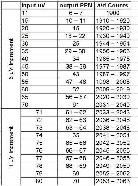

I just did some tests on the device and recorded the ADC values and PPM outputs, it really shows the averaging effects talked about previously.
obviously this gizmo is over my head.
three-ish counts per microvolt?
I'm amazed. Temperature change along your test leads can induce microvolts by the dozen.
Our 14 bit A/D had a 2 millivolt range which is around i think 8 counts per microvolt
but we being an industrial not a lab environment had a really hard time finding a microvolt standard to calibrate it. Fortunately we had no need of better than about ten microvolt accuracy, around a quarter degree on our thermocouples.
I cannot imagine how you resolve let alone produce nanovolts.
Point being - does observed 3 counts per microvolt mesh up with your expected resolution from your first post?
I thought you expected one count per 76 microvolts.
Yes, 76. uV, but with the 32x amplifier engaged it gives 2.375 uV.
Averaging n samples gives a Sqrt(n) improved resolution beyond that.
