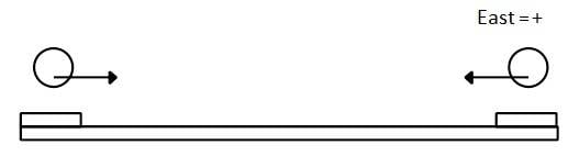

Two frictionless pucks are placed on a level surface with an initial distance of 20.0 m. Puck 1 has a mass of 0.80 kg and a charge of + 3 E-4 C while puck 2 has a mass of 0.4 kg and a charge of +3 E-4 C. The initial velocity of puck 1 is 12 m/s [E] and the initial velocity of puck 2 is 8 m/s [W]. Find the minimum separation of the two pucks?
[/B]
KE 1 + KE 2 + EE = EE' + KE'
Pt=Pt'
First I used conservation of momentum to calculate v for each mass at the min separation.
Both pucks have the same velocity.
Then just some algebra to isolate v'.
m1v1+m2(-v2)=(m1+m2)v'
v'=(0.80)(12)+(0.40)(-8)/0.80+0.40
v'=5.33 m/s [East]
This part I can use conservation of energy (kinetic and electric potential). I don't think the energy here would be negligible and doing calculations I see big differences in the answer.
½ m1v1² + ½ m2 (-v2²) + kq²/r = kq²/r' + ½ (m1 + m2)(v')²
½ (0.80)(12)² + ½ (0.40)(-8)² + (9.0 E+9)(+3.0 E-4)²/20 = (9.0 E+9)(+3.0 E-4)²/r' + ½ (0.80 + 0.40)(5.33)²
r' = 7.34 m
I've found so many attempts at this and there is so many answers.. Many I know are wrong and this one I think is right.
Please can you review this and see what you think?
Thank you
Julian

Doesn't look right to me. Did you forget the second term on the right ?
A few comments from my part:
Do you realize the 5.33 m/s is the center of mass speed ? Working the whole thing in the c.o.m. is a little easier to follow.
The exercise mentions a surface, not a rail. But I agree that a minimum distance is achieved when the puck move head-on.

1/2(0.80)(12)^2 + 1/2(0.40)(-8)^2 + (9.0e9)(+3.0e-4)^2/(20) = (9.0e9)(+3.0e-4)^2/r + 1/2(0.80 + 0.40)(5.33)^2
This gives me 8.63 m which now I think this is right...
But I'm curious as to which second term I may have forgot... I don't exactly have a math mind. Also I don't know what you mean about c.o.m. I'm new, sorry.
The centre of mass of the system of particles has a velocity given by [(m1)(v1)+(m2)(v2)]/(m1+m2). Here v1 and v2 are the respective velocities and not just speeds. You start seeing the two pucks in the centre of mass frame. Minimum separation will be attained when the velocity of both the pucks becomes the same as the velocity of the centre of mass,.i.e., in the centre of mass reference frame their kinetic energy becomes zero. Equate the initial energy K.E.+P.E. in the centre of mass frame of reference to the final energy in the same frame(when there will be only potential energy and no kinetic energy) and you'll get the answer. Your approach also seems right. I don't know why you're not getting the answer.

Haha... yes 8.63 should be the right answer...
