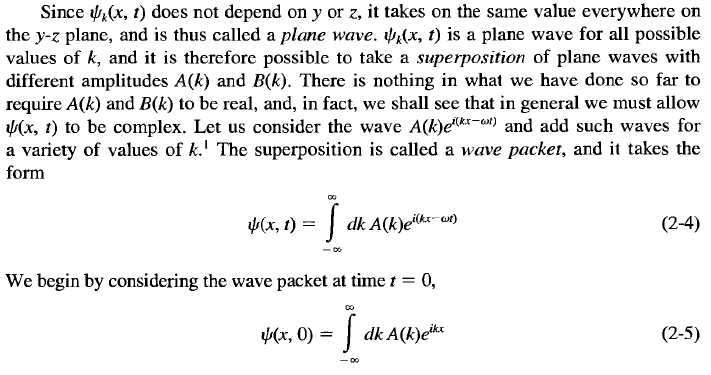

According to Gasiorowicz 2-1 equation:
$$ \psi_{k}(x,t) = Ae^{i(kx-wt)}+Be^{-1(kx-wt)} $$
## \psi_{k}(x,t) ## it is a plane wave. So, why is my statement not correct?About the waveform of the solutions: I'm saying that knowing that the initial condition of the paper is a solution of the TDSE for ## t=0 ##, ## e^{-i 6 k^{2}} ## comes from the plane-wave factor (equation 2-7 and the lines below of the Gasiorowicz) and without that factor there is no Gaussian wavepacket but only a Gaussian function that is not a solution of the TDSE.
An arbitrary function of (x-vt) is NOT a solution to TDSE.
The factor ##e^{-ik^2 6 } ## provides an offset in time (as does any factor of the form ##e^{iw_kt_0}##) in the Fourier Transform. This works only because ##k^2 \sim \omega _k##. The function is a solution without the factor but may not match the t=0 boundary condition.
Sorry you must have a newer edition of Gasiorowicz so I cannot follow explicit references. Please work through @vanhees71 solution: it is, as usual, quite complete
Likes vanhees71

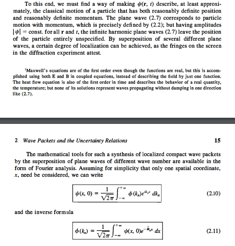

Of course plane waves are solutions of the Schrödinger equation, but not all solutions of the Schrödinger equation are plane waves as the example with the Gaussian wave packet shows: it's clearly NOT of the form ##f(ct-x)##.
The reason is that the plane-wave solutions are the energy eigenstates. For a free particle these are the momentum eigenstates,
$$u_p(t,x)=\frac{1}{\sqrt{2 \pi \hbar}} \exp(-\mathrm{i} \omega_{p} t+\mathrm{i} k x)$$
with
$$k=p/\hbar, \quad \omega = \hbar^2 k^2/(2m).$$
This quadratic (i.e., non-linear) dependence between ##\omega## and ##k## is the reason why, in contradistinction to solutions of the 1D wave equation, the general solutions of the 1D Schrödinger equation are not (superpositions of) plane waves (see my previous posting).
It's a long time ago that I learned some QT from Gasiorowicz's book, and if I remember right, it's a pretty good textbook. I don't think that this author claims that the general solutions of the free 1D Schrödinger equation are (superpositions of) plane waves.
The solutions of the 1D TDSE (with ## V=0 ##) are plane waves (Or combinations of plane waves):
$$\psi_{k}(x,t) = Ae^{i(kx-wt)}+Be^{-i(kx-wt)}$$
This statement is undeniable. You can check this anywhere:
http://hyperphysics.phy-astr.gsu.edu/hbase/quantum/Schr2.html
http://physics.gmu.edu/~pnikolic/PHYS308/lectures/schrodinger.pdf
https://www.electrical4u.com/schrodinger-wave-equation/#:~:text=The%20Schr%C3%B6dinger%20equation%20(also%20known,by%20solving%20the%20Schr%C3%B6dinger%20equation.
http://www.astro.uvic.ca/~jwillis/teaching/phys215/phys215_lecture4.pdf
You can find a solution that is not a plane wave, but, since you really understand what is the Fourier Analysis you realize that any "reasonably well-behaved" function is a superposition of plane waves (check https://scholar.harvard.edu/files/david-morin/files/waves_fourier.pdf).

Please, could you give a reference to the general solutions of the free 1D Schrödinger Equation that you are talking about?
Thanks.
Your plane waves are not even true states, because they are not square integrable! For the free field from the momentum eigenstates I derived above you find the most general solution of the TDSE as

Some references (I don't know if this is legal but I'm getting crazy with this thread :D):
- From the Gasiorowicz, Quantum Physics :
- From the Merzbacher, Quantum Mechanics :
About the normalization of the plane waves:
https://physics.stackexchange.com/questions/165373/normalizing-the-solution-to-free-particle-schrödinger-equation
What you quote from Gasiorowicz is precisely what I wrote. What's missing is just the dispersion relation, ##\omega=p^2/(2m \hbar)##, but I'm sure that it's writting somewhere in the book.
The plane waves are generalized functions (distributions) and not square integrable functions. They are "normalizable" to a ##\delta## distribution, indeed with
