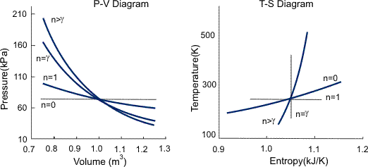

OP's confused using ideal equations to the actual condition, wherein there's no term as "reversible condition" in the real world, he asserted which is true.
My say about this is: these are smoothened plots basing on ideal models. The actual process or states is actually off +/- the computed values from these models.
What is important with this is we can quantify standard or the ideal values and compare actual measurements. Thus, from a mathematical point of view, prediction can be made in advance in the design and prior implementation of systems involving these concept.
See for example figure attached. I say PVn=const. is not ideal anymore on the actual conditions. Where n≠0(no such actual process as -isobaric), n≠1(no such thing as isothermal), n≠k (no such thing as isenthalpic) and n>∞ isochoric process.
Actual values might be close to this curves(sets of state points) but, real thing, there is no such thing as ideal gas and reversible process, thus n deviates from ideal condition on actual measurement of PVT properties.
I think what you are trying to say is that a reversible path is an idealization that an actual process path can be made to approach as the driving force for the change is caused to approach zero. In my judgement, this does not relate materially to the OP's original question. The OP confirmed that his question was fully addressed by post #3. Therefore, I am closing this thread.
