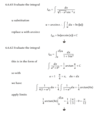

ok this is from my overleaf doc
so too many custorm macros to just paste in code
but I think its ok,,, not sure about all details.
appreciate comments...
I got ? somewhat on b and x and u being used in the right places

Ummm...
What exactly is your question?
-Dan
OK this one was kinda obvious but usually that is where I make the errors especially where there is substitution.
I post another one here soon.:cool:
karush said:
That all looks correct to me, except that at one point in the solution of 6.6.62 you have written $du=dx$. That should be $\dfrac{du}4 = dx$ (which is what you have correctly used in the following line).
