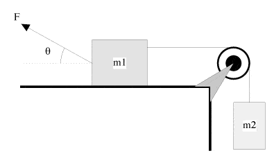

A 28.3-kg block (m1) is on a horizontal surface, connected to a 5.5-kg block (m2) by a massless string as shown in the Figure. The pulley is massless and frictionless. A force of 208.9 N acts on m1 at an angle of 29.7o. The coefficient of kinetic friction between m1 and the surface is 0.201. Determine the upward acceleration of m2.
M1-------O
M2
I'm not sure how to post pictures within my message just yet.
X and Y components of the force on F1
Sum F = M * A
Kf = uK * Fn
g = 9.8m/s
**Y+ is upwards and X+ is to the right**
I found the X and Y components of the Force on M1
I added M1 and M2... not sure if I need this but just in case.
And I drew Free Body Diagrams for both M1 and M2
- M1 has Normal Force acting Y+, which equals its Weight (m*g)... M1 also has Friction and Tension acting X+... the x component of the force acting X-
- M2 only has Tension acting Y+, and Weight (mg)... I suspect the tension to be equal to the tension... but I'm not sure.
Thanks! I hope I gave you enough information!

Show your equations. The figure is very nice.

Known
m1 = 28.3
m2 = 5.5 kg
theta = 29.7
f = 208.9
uK = 0.201
Want
Acceleration of M2 in the Y direction...
________________
Fx = 208.9 cos (29.7) = 181.457
Fy = 208.9 sin (29.7) = 203.501
M1 + M2 = 28.3 + 5.5 = 33.8 (M3) (I'm not sure if I'll need this)
_____________________
For M2
Sum Fy = M*Ay
T - m*g = M* Ay
For M1
F - T - Friction = M * A
F - T - uK * Fn = M * A
_________________
Thats all I have at the moment... :/
Does this suffice?
Use M1 and M2, respectively, in the equations for M1 and M2. They are not the same, and what is m in the equation for the hanging mass?
The length of the string does not change, so the magnitude of the vertical acceleration of M2 is the same as the horizontal acceleration of M1.
When you corrected the equations, add them: T will cancel and you can solve for the common acceleration a. Show it.
ehild
M1: F-T-ukFn = m a
(208.9cos(29.7)) - T - 0.201*277.34 = 28.3*a
M2: T - mg = m a
T - 5.5*9.8 = 5.5 a
(T - (5.5*9.8) ) / 5.5 = a

How would I solve for something like this? Two variables?
You assumed that M1 moves on the left and M2 moves upward. It is not sure that true, but try. Then write:
M1:
F cosθ - T - μ Fn =M1a,
Fn=M1g-F sinθ, so
F cosθ - T-μ(M1g-F sinθ)=M1a.
M2:
T-M2g=M2a.
You can plug-in the numerical data at the end.
Add the equations in bold, or express T from the second one and substitute in the first one.
ehild
208.9 cos 29.7 - (5.5 a + 28.3 * -9.8 ) - 0.201 ( 208.9 - sin (29.7) ) = 28.3 - a
a = 86.357?
Yeah, this is not making sense... sorry. Can you please explain it again?
nerd, do as ehild said. "Add the equations in bold" it will cancel out T, then solve for a
EDIT: i can't emphasize the importance of a free body diagram enough. Always draw a FBD for different bodies in question.
believe me, life becomes easier when one does

Correct the red parts of the equation. g=9.8 m/s2, its direction was taken into account in the second equation. I can not imagine, why did you make 28.3-a from M2a. Isolate a, it is present at both sides. Take care of the parentheses.
It is better to solve a problem symbolically, and plug in data at the end.
