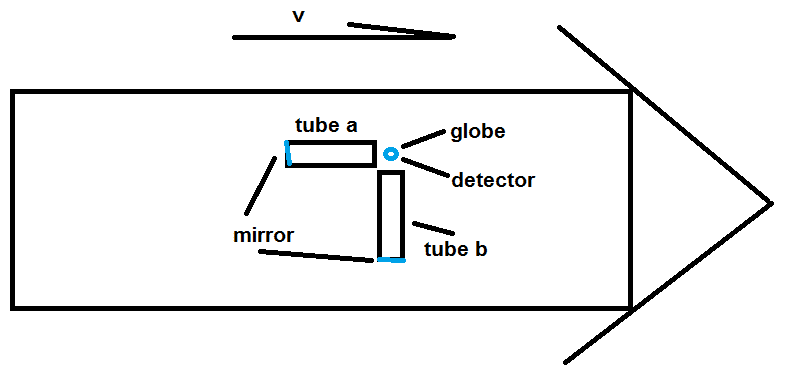

I can't see the error in this can someone please explain where I went wrong?
A man is in a spaceship traveling at a constant velocity
He makes 2 identical tubes of length L with a mirror at one end, tube a and tube b
He has a single light bulb. Next to the bulb is a detector. He carefully measures that the bulb and the detector are equidistant from the mirrors.
He places the non mirrored ends of the tubes at the globe, with the tubes perpendicular to each other see the figure
The detector detects if 2 flashes of light arrive at the detector at the same time. The bulb flashed for a brief instant and the detector detects if the flash arrives from each tube at the same time.
The analysis for tube “a” is
T = ((L – vt)/c) + ((L + vt)/c)
(L – vt)/c = is the time taken for the light to leave the light source and travel to the mirror.
(L + vt)/c = the time to do the return trip.
T = the time taken for the round trip
The analysis for tube “b” is
T = 2L/square root(c^2 - v^2)
But
2d/square root(c^2 - v^2) does not equal ((L – vt)/c) + ((L + vt)/c)

If you are including the speed of the ship in the analysis then you are not working in the rest frame of the ship. What happens to the tube parallel to the motion of the ship in that case?

Say the globe flashes at t1. If the spaceship is moving at a constant velocity v won't the clock be in a different position in space when the flash arrives at the mirror say at t2?
Ross B said:
Say the globe flashes at t1. If the spaceship is moving at a constant velocity v won't the clock be in a different position in space when the flash arrives at the mirror say t2?
In a frame where theship is moving, yes. But in such a frame, what happens to the length of tube a?
the length of tube a, according to the man at rest wrt tube a is L, as he measured it just before he made the tube?
all the external observer does is measure the velocity and direction of each space ship. They cannot see the experiment
It does for v=0, which is the case in the ships reference frame.
You can use this fact to derive the length contraction formula in other frames.
but v does not equal zero ...so I sort of fail to see yr point ?

What you are describing is similar to the Michelson Morley experiment and your error was their (failed) hypothesis, which led to the recognition that there was no aether or universal rest frame:

Your basic error here is that you are mixing and matching frames inappropriately when doing the analysis. You can't measure the tube length in the stationary frame and then apply that length to a different measurement done in a moving frame. You must be consistent. And the easiest way to do that is for each ship to declare themselves stationary and then predict their experiment will show no motion.
If the other ships *could* observe each other's experiments, then you could have one ship monitor the experiment and see what results you would get -- but the catch is that they don't just have to measure the time remotely, they also have to measure the length of the tubes remotely. You cannot mix and match measurements in different frames.

Ross B said:
another thing I don't understand is they say the laws of physics are the same in all frames. But I would have difficulty explaining a self contracting tube?
does it affect the density of the material that the tube is constructed of?
A moving tube is a short tube, a dense tube, and what else ... a slowly aging tube.So let's say we want to pump all the water on Earth through a tube whose diameter is 0.1 m in one second. We can do that because the very fast moving water becomes very dense water, right?Of course there are always some observers saying that the water in the tube is not moving. Those observers are also saying that the density of the water is the normal density of water, 1000 kg/m3
  • #33
Ross B said:
Does that mean if I am standing on a train station with train carriages whizzing by with all the doors open and I repetitively stick my hand in and pull it out of the moving carriages , my hand will shrink and elongate ?
The train whizzes by and is contracted. While the hand is not whizzing by and is not contracted. This is very straightforward stuff :smile:
And as always there are some observers that say that the hand is whizzing by, and those observers say the hand that is whizzing by is contracted.
  • #34
Ross B, I suggest you study the Michelson-Morley experiment, which is basically the same as your thought experiment.
Whenever you specify the velocity of something, you have to also specify what your frame of reference is, if it is not implied. It's incomplete to say that the train is moving at 100 km/hr. You have to say, the train is moving at 100 km/hr relative to the Earth's surface. If I am on the train, then I am also moving 100 km/hr relative to the Earth's surface. But I am moving at 0 km/hr relative to the train. And the train is moving at 0 km/hr relative to me. And the Earth's surface is moving at -100 km/hr relative to me. I am moving at 0 km/hr relative to me.
The length of something depends on the frame of reference. Since I am moving at 0 km/hr relative to me, I do not see myself as contracted. The train is moving at 0 km/hr, so it is also not contracted. The Earth is moving at -100 km/hr so it is contracted slightly in the direction of motion. If the Earth stops moving (because the train applies its brakes), the Earth becomes longer.
No. You seem to think of a frame of reference as something that you can move your hand into and out of. A frame of reference isn't a physical thing, but a choice of coordinates. You can be inside the train and measure your motion relative to the Earth, or to the train, or to yourself, or to any point you choose.
