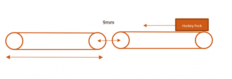

I am trying to find the time it will take for a parcel to pass over one conveyor belt
The conveyor on the right is Conveyor A The conveyor on the left is Conveyor B
they both have a length of 700mm
Conveyor A has a constant speed of X
Conveyor B has a constant speed of Y
The hockey pick has a radius of 80 mm
The coefficient of friction is Z
the hockey puck is initially moving at speed X
I need to find the time it will take for the parcel to pass completely over Conveyor B ( shown with arrow in picture).

The question I believe lies at the point where the puck crosses from the first conevyor belt to the second.

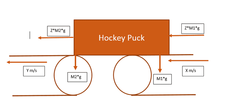

I have this force diagram but I am not sure if it's right

You need to consider a more general state during the cross-over. When there is a length x on conveyor B, how much weight will be on that conveyor? You will have to make some reasonable/idealised assumptions to answer this.

No. Imagine making the B conveyor much longer. The distance the puck travels on B before coming to the same speed as B does not keep increasing. It is controlled by the coefficient of friction.
You could get an approximate answer by just supposing the puck is dropped onto B with the horizontal speed of A and calculating the time it would take to accelerate to the speed of B. But if that were the expected solution I do not see why they would have given you the 9mm separation distance.

It's not a homework questions, I am actually working with conveyor belts and need to calculate the speed the conveyor B based on time it takes for the parcel (hockey puck) to pass conveyor B. So this is real life problem not a homework.
With that said being said. Your second part suggesting calculating the time it would take for the puck to reach speed B, how do I do that ?
I figured that the puck would instantly have the speed of conveyor B as the puck won't slide and hence it will have a speed of 0 relative to the belt
But in your earlier attempt you assumed a constant acceleration.
You quote a coefficient of friction. Is that kinetic or static? If it is kinetic, what is the frictional force when sliding? What acceleration does that give?
