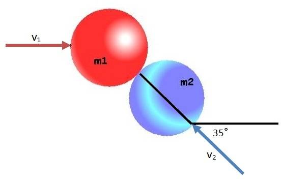

This is a modified problem from the one posted a few days ago. I’ve been unsuccessfully trying to solve it since then, so maybe it’s time to ask for some help.
I’ve changed the quantities :)
1. Homework Statement
The mass of puck 1 is ##0.2\ kg## and that of puck 2 is ##0.25\ kg##. The initial velocities are ##v_1 = 1.5\ m/s## and ##v_2 = 0.8\ m/s##.
Assuming no friction between the pucks, only normal forces during collision, find their final velocities.
Data:
##m_1 = 0.2\ kg##
##v_1 = 1.5\ m/s##
##m_2 = 0.25\ kg##
##v_2 = 0.8\ m/s##
##\theta: -35º##
##p_{1x} + p_{2x} = p_{1x}’ + p_{2x}’##
##p_{1y} + p_{2y} = p_{1y}’ + p_{2y}’##
##KE_{initial} = KE_{final}##
For a while I thought I was done, but I wasn’t. I’m doing something wrong. Whether is the wrong coordinate system, the signs and/or the math, I don’t know. I appreciate any guidance.

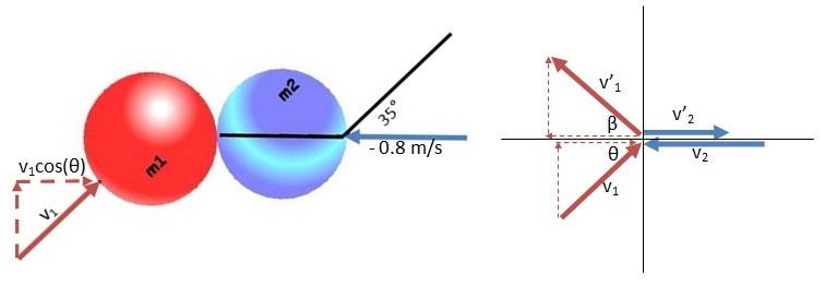

First, I chose a coordinate system so that the line of impact lies along the x-axis. After the collision, one ball will move away from the origin along the line ##y = 0##, while the other will bounce in the sort of wall formed by the y-axis:
Having established that, ##\theta = 215º##, ##v_2 = -0.8\ m/s## and ##v_2’## will be in the positive direction.
x-axis:
##m_1v_1\cos(\theta) + m_2v_2 = m_1v_1’\cos(\beta) + m_2v_2’##
y-axis:
##m_1v_1\sin(\theta) = m_1v_1’\sin(\beta)##
##v_1\sin(\theta) = v_1’\sin(\beta)##

##y_2## turns out to be the velocity before the collision, so ##v_2' = 1.24\ m/s##. Then ##v_1'## is found to be ##-1.06\ m/s##. These values agree with a CoM of ##0.1\ kg\dot\ m/s## and a Co(KE) of ##0.305\ J##.
When vectors lie right in the x or y-axis it's easy to spot their sign, but I have trouble associating the sign with vectors that don't lie along one of the axis (It was a problem when finding ##v_1'## with the quadratic, instead of ##v_2'##). Do I have to take a look at their slopes to figure that out?
The direction of ##v_1'## is ##-54.6º##. Is my diagram wrong? Or do I have to interpret that as ##180º -54.6º = 125.4º##?

What is still bugging me is the direction of the angle of v_1'. I calculated it again:
##\beta = \arcsin\left(\frac{v_1\cdot sin(\thetaº)}{v_1'}\right) = \arcsin\left(\frac{1.5\cdot sin(35º)}{1.24}\right) = 47.74º##
That's because of my chosen coordinate system, right? should it be understood as ##47.74º## from the y-axis?
No, it's from the x-axis (line of centres at collision), as drawn. Why do you think it should be from the y axis?
