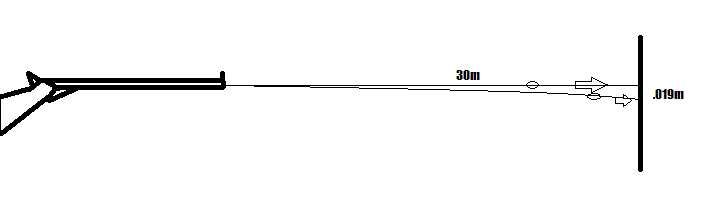

A rifle is aimed horizontally at a target 30m away. The bullet hits the target 1.9cm below the aiming point. what are the bullets time of flight and the initial velocity?
ax=0
g=9.8m/s^2
x0=0m
xf=30m
y0=0m
yf=.019m
v0x=?
vfx=0m/s
v0y=0
vfy=0
t=?
Here is a little picture i drew to visualize everything
.019=v0y*t +1/2*g*t^2
.019=4.9*t^2
sqrt(.019/4.9)=t
t=.0623s
30m=v0x*t +1/2*ax*t62
30m=v0x*.0623s
v0x=481.77m/s
Is this correct? It seems about right. I have a small time, and a high velocity. I just want to make sure that I'm right.
Looks good!
