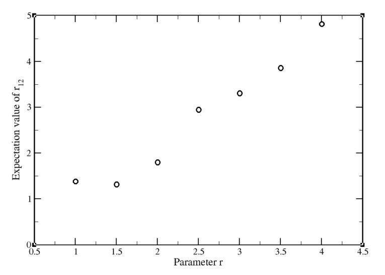

Two electrons are put in a potential well of decreasing width. What happens to the mean distance of electrons?
I did some calculations for the ground state energy and wave function of a system of two electrons put in a finite-depth 2D potential well. Regardless of the shape of the potential well (square or circular), the expectation value of the electron-electron distance ##\langle r_{12}\rangle = \langle\psi_0 \left.\right|r_{12}\left|\right.\psi_0\rangle## first becomes smaller when the diameter of the well is decreased. But at some point it increases again. Is this because the two electrons "give up" trying to fit in the potential well when it's too narrow, or is it more likely that I haven't set up my diffusion monte carlo parameters properly?

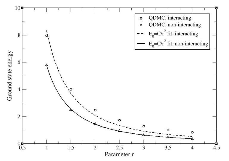

For example, one calculation had 2 electrons inside a potential well the shape of a circular disk, and potential energy jumping from 0 to 20000 Hartree when crossing the circular boundary. A parameter ##r## is a multiplier of all linear dimensions of the system, with the area of the circle being ##3.14## Bohr##^2## when ##r=1.0## and ##(3.14## Bohr##^2 )r^2## when ##r## has some other value. The ground state energy ##E_0## of the system behaves like this as a function of ##r##:
The solid line is a case where the electrons have been made non-interacting and the dashed line describes one with the Coulomb force included. A function of form ##E_0 \propto r^{-2}## fits well in the non-interacting case (and it fits perfectly if the depth of the well, ##V_0##, is infinite).
The equivalent result for ##\langle r_{12} \rangle## as a function of ##r## is increasing for ##r>1.5## but decreases when going from ##r=1.0## to ##r=1.5##.
I'm not telling too much detail as I'm possibly trying to publish the results somewhere at some point. I already got myself convinced that ##\langle r_{12}## doesn't increase monotonically as a function of ##r## when the well depth ##V_0## is not infinite.

Thanks. I don't see the interacting ground energy increasing in that graph, does that occur beyond 4 Bohrs?
The ##E_0 (r)## should not increase on any interval, unlike the electron-electron distance expectation value. When you make the potential well larger, the two particles can have a smaller kinetic energy and also more effectively minimize the Coulomb potential energy.
Edit: A plot of the data points for ##\langle r_{12}\rangle## as a function of ##r## looks like this for a well depth of 20000 Hartree. The quantities on the axes have dimensions of Bohr and Hartree, but can equally well be seen as dimensionless.
I see, curious to see how the expectation value behaves for small trap radii.
