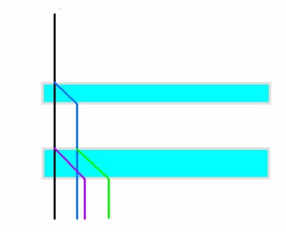

It is my understanding that the "ordinary" ray that enters the crystal exits as parallel ordinary and extraordinary rays. One dot becomes two dots. As I understand it each of these rays are linearly polarized orthogonal to each other. If those rays then travel through another crystal, what is the effect on each of these rays?
I understand that a ray of light entering a birefringent crystal becomes polarized into 2 perpendicular linearly polarized light rays that emerge parallel and displaced by a distance. If the 2 rays then pass through a second crystal with the same orientation, say for example the first crystals displace +5 microns vertically and the second +10 microns vertically, how many rays will emerge? Will the ordinary or extraordinary be blocked by the second crystal because of its polarization, if so which one?
You can see what the whole setup does for one polarization axis of incoming light and for the other separately.
If the orientation is the same the birefringence of the second crystal does nothing special, it just increases the separation.

Thank you for taking the time to answer. I do not follow what you say here:
"You can see what the whole setup does for one polarization axis of incoming light and for the other separately."
could you expand please?
In the question I posit 2 stacked crystals with the same orientation. You have told me that it just increases separation, but please be more specific as far as the number of rays produced. Stated differently (and not very technically!) the image of a dot passes through the crystal and becomes two separate dots displaced by the crystal's properties. Will each of the dots be reproduced and doubled again if they pass through another similarly oriented crystal? Will polarization extinct (hah not a verb?) any of the rays/dots?
