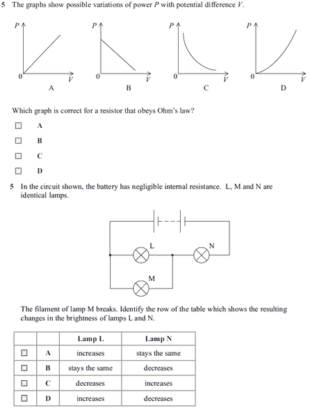

I've done both these questions with correct answers, but I just want sure that I chose the right choices for the right reasons. The questions are:
V = IR
P = I2R
P = V2/R
The answers for both are D.
The reason I chose D for the first one is because P/I2 = R And due to Ohm's law R is constant, so I2 = P So the graph should look like a y = x2 graph.
The reason I chose D for the second one is because the brightness of the lamp depends on the power output so since P = I2R an increase of I (Due to Kirchovs first law) across L would mean a larger power output across L, and a decrease in I (because of the increase in R across the parallel part) across N would mean due to the same equation that P would decrease. For this particular question is it 100% necessarily to use the power equations or could you just say that a larger current means a greater brightness and then just deduce the answer from Ohm's law because the Examiner's report didn't mention anything about using the power equations...
But there's no I on those graphs, only V … you need an explanation that uses V instead. :redface:
Technically, you're correct … brightness means power …
but in practice we just use the fact that (for a particular component) that brightness increases with current, so no you should just use current.
The current is not the same through each lamp, so you'll have to describe what happens to the currents more carefully.
It should be clarified that the current going through each lamp is not the same before the filament of lamp M breaks. Once the filament of lamp M breaks, you are no longer dealing with a circuit containing parallel resistors (where the current varies, but the voltage remains constant), but with a pair of resistors in a series (where the current remains constant, but the voltage varies).

I meant V^2/P sorry not P/I^2 (typo). And yes the current stays constant throughout the whole circuit (after removal of parallel light bulb) and increases relative to L and decreases relative to N.
Why?
Describe what the currents are before and after (with numbers).
Before:
RTotal = 3R/2 Because of R + 1/(1/R + 1/R) = R + R/2 = 3R/2
So ITotal = V/(3R/2) = 2V/3R
IL = ITotal/2 (identical lamps) = 2V/6R = V/3R
IN = ITotal = 2V/3R
After:
RTotal = 2R Because RTotal = R1+R2 = R+R = 2R
So ITotal = V/2R
IL = IN = ITotal = V/2R
V/2R < 2V/3R So IN Decreases
V/2R > V/3R So IL Increases
excellent! :smile:
that's the way to do it! :wink:
