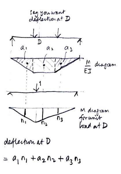

I am cerious how to calculate a simple 2 point moment using the formula Mm dx/EI
Lets say i have a span of 43 1/2" with 2 5000lb loads 10 3/4" from each side. Each side is simply supported. My inertia of my beam is 4
I have drawn a moment diagram but i can't seem to translate it to diflection. I know that M represents moment. My first moment is 5000*10 3/4 = 500011 lb-in. So with the formula above i can calculate a deflection at any point. This is where i get lost. I read that m is the unit load where i want to calculate my deflection. I suspect that would be 5000lbs? What is dx in this equation? Obviously E for steel is 3.0x10^8 psi. I listed above as 4
I would appreciate it if someone could enlighten me on this formula. This is a simple calc and can be done other ways, I just want to be familar with this formula so i can use it on more adavanced calcs.

This is not a complete answer to your question but it is how I would do it, and you might be able to work out what m and dx are from my answer. (What is missing from your question is the integral sign in front of "Mm dx/EI", and the limits that go with it. My method attached is a practical way to solve this integral in simpler cases. Let's call it the An method. A is the area of the M/EI diagram, which in this case is partitioned into areas a1 a2 and a3. We want the deflection at (say) any point D. Put a unit load at D. Draw its M diagram, and identify in that diagram the ordinates corresponding to the centroids of the areas a1 a2 and a3 in the M/EI diagram. Then Deflection at D is a1n1+a2n2+a3n3. Of course this can be done with formal integrals, but, even though I am perfectly capable of integrating, this semi graphical approach appeals to me for its practicality, even when a UDL and parabolic diagrams are involved. I hope the figure comes out. I haven't attached one before...

So if i placed D in the center of the beam I come up with a deflection of .0012" with an I value of 4. Is this correct?
To find a1 I did (10.75*5000)/2 /EI = 2.240e-4 - a3 has the same value because its symmetrical where my loads are.
a2 is 5000*22 /EI = 9.167e-4
To find n1 I used methods from this site to find Cx - http://www.efunda.com/math/areas/triangle.cfm
Cx = 7.167 from left. I then found my angle of triangle to be arctanØ = 1/10.75 = 5.315° - tan(5.315) = y/7.167 = .667. n1 is .667 - n3 is the same because my unit load is placed symmetrically.
n2 is on D so n2 is 1.
2.240e-4*.667 = 1.494e-4 * 2 (both sides) = 2.988e-4 + 9.167e-4 = 0.0012"
Did I do this correctly? I do like your method. Its similar to what I was asking, For all I know, it seems to be the same - Yes you are right, i forgot the sum of in front of my equation.
Thanks for the post. Let me know if I was interpreting your method properly.
I noticed an error... my triangle is 1/21.75 making n1 = .334 Ironically I did that initially on paper and when I typed my answer here i thought i made an error. Answer still comes up pretty close to the same even with the error. If my process was correct.
I think you may have misunderstood the n diagram. It is the bending moment diagram for a unit load at the point of interest. So the central ordinate is not 1 but 1xL/4 which is 43.5/4 = 11.75 lbin. I think this makes n1 = 5.22, but I usually work in SI units, so could have made a silly error.
OHHH okay.. let me review the problem again.
So using trig to find my point at n1 was correct tho? sure there's different ways to find it but that seemed to be the easiest for me

I made a silly error. I now agree your value of n1. Also n2 is not what I said before but 10.875 So a1n1 + a2n2 + a1n1 again is .008 +.1 +.008 = 0.116 inches. So how did you get 0.012"? This may not help but the steel designers manual has a formula for this deflection and it gives .00973". So I conclude we are both struggling here. If the point loads were at the 1/3 points (14.5" from the ends) the formula is [23PL^3]/[648EI] and your deflection should be a bit less than that.
You said a1 would be - area1/EI? So if i got 5000lbs x 10.75in = 53750lb-in then because its a triangle divide that by 2 = 26875lb-in/ E = (30,000,000 psi for steel) * I = 4 = 2.240x10^-4would this be correct? I take that value times my n1 value of 3.58 = 8.018x10^-4 * 2 (because my opposite side is the same because my load is symetrical) = 0.0016" + a2n2
a2 = 5000lb * 22in = 110000lb-in/EI = 9.167x10^-4 * 10.875 = 0.00996 or 0.0100"
0.0016" + 0.0100" = 0.0116"

This last message shows me how I slightly misled you. The sum of Ai*ni was right in principle, but a2, the central zone should have been taken as two parts, because the m diagram is different to the left of the centre line than the right. What i would like to know is: Can you do definite integrals? Can you take the origin as the left hand support and write down the three functions: (1) M diagram in the range 0 to 10.75 (2) M diagram in the range 10.75 to 21.75 (3) m diagram in the range 0 to 21.75, all as a function of x?. If you can do that, you should get an expression that you can integrate between the limits, add the two results together, divide by EI. Finally multiply by 2 because of symmetry (or develop new functions for the right hand side of the diagram, and show you get the same values, which you add to the first lot). You wanted a generalised method, which the integration method will do if you can write down the functions etc. You could use the sum of An method as a check. (An engineer will always look for independent checks on important calculations). Good luck.

Pl^3/48EI is correct for a centrally loaded simply supported beam. You shouldn't multiply the areas together, as you have done. The reason I asked if you could write down the functions of M and m is so that you could multiply those functions together, not their areas. If you are having to ask about dx then you haven't done calculus. This is not the time or place to teach it to you, but you can try it next year when you have done integration. Meanwhile I suggest you use approximate formulas or the An method. Best wishes.

I admire your perseverance. So here is some extra work for you!
First of all, dx is not d multiplied by x. It is a single concept called “dx” which is vanishingly small but not zero. You need to study calculus to get it. However, if you want to calculate the area enclosed by a function of x, you can divide it into a number of vertical strips, approximating to thin rectangles. Then add the areas of all the thin rectangles, each with a width delta x. Under a curved function there will be a small error, but the error is minimized by reducing the width of the rectangles; dx is the name given to delta x as delta x approaches zero. (This website doesn't allow the lower case greek d we call delta) End of calculus lesson. Now for the functions.
If you take the left hand support as the origin, then I hope you agree the m diagram is a triangle with point at the centre. In the region 21.75<x<43.5 the m diagram is a straight line that has to satify two points (43.5, 0) and (21.75, 10.875) where 10.875 is an interpretation of “PL/4” with P=1. If the equation of this straight line is y=ax+c, where a and c are coefficients, then you can substitute the two known points into that equation and obtain two simultaneous equations, which, when solved, should give you the equation y= -0.5x +21.75 As the signs depend on your sign convention for moment, you might get the negative of this: y= +0.5x-21.75 If you understood that, you should be able to work out what all the other functions are...
