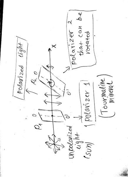

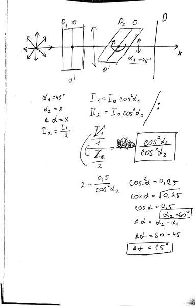

An angle is given between 2 polarizer's (45 degrees), through them light passes (unpolarized than after passing through the first one it polarizes), some of the light its shown on the display. For how much does the angle needs to be increased for the intensity of light to be 2 times less if the starting angle is 45 degrees.
Given Var:
α=45°
I=I0cos2α
The answer in textbook:[/B]
α21=+15°
My work:
My answer:(Side note I have a little error instead of II2 its I2, everything else is correct).

You did not answer my question. If the intensity of the beam is I0 before the first polarizer, what is it after that polarizer? I am talking about the intensity between P1 and P2 in your drawing. There is no 45 degree angle involved, yet.
It starts with 45 degrees.BTW I solved it, found my errors and I will post my answer now.
Please do so.
Instead of II2 is I2=I1/2
Looks good.
