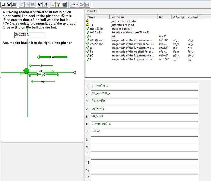

Problem 1: A .145 kg baseball pitched at 40 m/s is hot on a horizontal line back to the pitcher at 52 m/s. If the contact time of the ball with the bat is 4.7e-3, calculate the magnitude of the average force acting on the ball due to the bat.

My attempts at a solution are shown in the jpegs, with enumerated variables and equations I've tried. As for the method behind the madness, For problem one I am going off of the face that since impulse is the change is momentum, I can obtain a value from the quantifiable values for the momenta and then set the impulse equal to F delta t isolating the force in question.

I can not follow your calculations, what have you got for the change of momentum in the first problem?
ehild
For the problem about impulse I have J=F (delta t)=delta p
F(t)=m(v2-v1)
F(4.7*10^-3)=.145(52-40)
Thus F=(.145(52-40))/(4.7*10^-3)=370.213 N
Apparently that is incorrect, but I am unsure of exactly what other equations to use with the quantities I have.
The change in momentum I got was (.145*52-.145*40)=1.74 (Kg*m)/s

You forgot that the initial and final velocities have opposite directions. If v1 is positive, v2 is negative. Think it over.
ehild
Ah I see what I did now, so with the revised computation the correct solution is 2838.298 N which I checked and it works. Thank you
