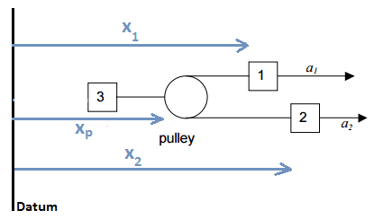

Two trucks tow a third one by means of inextensible ropes and a pulley attached to them (fig. 1). The accelerations of the two trucks are a1 and a2. What is the acceleration of the third truck that is being towed?

Hello. Welcome to PF!
The accelerations of trucks 1 and 2 are not necessarily the same. This is a kinematics problem. You do not need to work with forces.
For problems like this, it is often helpful to use the fact that the total length of a rope must remain constant. Consider introducing distances from a fixed line ("datum") as shown below. Can you relate the distances x1, x2, and xp to the length of the rope connecting trucks 1 and 2?
So that'll be length = x1 + x2 -2xp ?

Will it be then length of rope = x1 + x2 - 2xp = constant
And perhaps take the double derivative of that?
Yes!

The one used to answer the question above...so x1+x2-2xp.I get that the length of the rope is x1+x2-2xp but I don't understand how you differentiated it and how that led to the answer.
So the equation is L = x1 + x2 - 2xp, where L is the length of the rope. What do you get if you take one time derivative of each side?
I don't know.
What does the time derivative of x1 represent?
Velocity?
Seneka said:
Velocity?
Yes. So, you could write the time derivative of x1 as v1.
Where are you going with this?
So, x1+x2-2xp=l
v1+v2-2vp=vl?
a1+a2-2ap=al?
a1+a2-al=2ap?
(a1+a2-al)/2=ap?

So, x1+x2-2xp=l
v1+v2-2vp=vl?
What does vl represent? The ropes are given to be "inextensible".
What does this imply about the right hand side of your equation x1+x2-2xp=l?
TSny said:
Hopefully to some insight :oldsmile:
I appreciate your patience.
vl=0 there is no change is l
you could rearrange to get vp=(v1+v2)/2
I guess if you do the second derivative you get ap=(a1+a2)/2
Am I right?
Am I right?
Yes. Good work.
