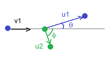

@Jam51: The velocities of the balls enclose different angles with the original direction. It is easy to prove what WrongMan said, that the angles add up to 90° when particles of equal mass collide elastically.
You have the following equations:
v1=u1 cosθ +u2 cosΦ
0=u1 sinθ-u2 sin Φ
u12+u22=v12
Square the first two equations, and add them.
v12=(u1 cosθ +u2 cosΦ)2+(u1 sinθ-u2 sin Φ)2 ---> v12=u12+u22+2 u1 u2 (cosθ cosΦ-sinθ sinΦ)
Because of conservation of energy, v12=u12+u22, so 2 u1 u2 (cosθ cosΦ-sinθ sinΦ) =0. But the term in the parentheses is equal to cos(θ+Φ) =0 so
θ+Φ=90°.
Likes Jam51

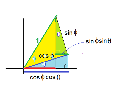

We had the equations
v12=u12+u22+2 u1 u2 (cosθ cosΦ-sinθ sinΦ) and
v12=u12+u22.
They can be both true if cosθ cosΦ-sinθ sinΦ=0.
The cosine of the sum of two angles can be derived according to the figure:
There are three right triangles, yellow, blue and green. The hypotenuse of the yellow triangle is 1. Those of the blue one and green ones are cosΦ and sinΦ. Cos(θ+Φ) is the length of the red line, which is the difference between the blue line and green line.
Likes Jam51
