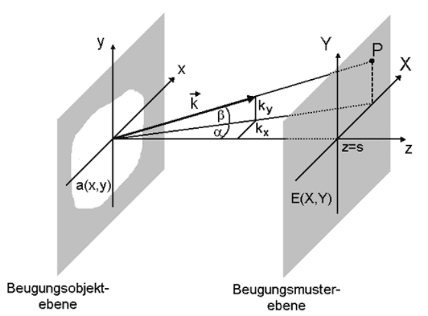

Can step back a bit?
In Post #1 could ##k_x## and ##k_y## actually be related to direction cosines (rather than corresponding to positions on a screen)? So ##k_x## would be related to direction in the ##xz## plane and similarly for ##k_y## in the ##yz## plane.
If that were the case then the “single sharp peak” referred to in Post #1 would be consistent with a distribution at a single angle in the ##yz## plane (rather than some angle-dependent distribution which we know we have in the ##xz## plane). The Post #1 solution would then be correct! (If so, @ergospherical's approach will of course give the same answer.)

In fact, ##k_x## and ##k_y## are given as ##k_x = k \cdot \sin(\alpha)## and ##k_y = k \cdot \sin(\beta)##. The angles are best specified by a picture. I'll attach it to this comment.
