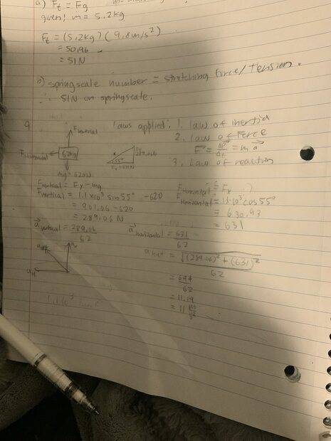

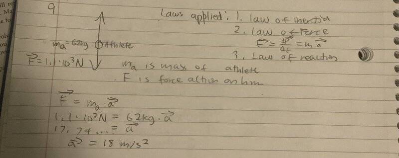

An athlete with a mass of 62 kg jumps and lands on his feet. The ground exerts a total force of 1.1 x 10^3 N [backward 55 degrees up] on his feet. Calculate the acceleration of the athlete
F=delta p/delta t =ma
this is my work but the answers say 11 m/s^2 so I made an error somewhere. Also if someone could help me with solving the direction for the acceleration, that would be greatly appreciated.
Perhaps because you have omitted the "backward 55 degrees up" direction of the reactive force.
yay, I figured it out. I still have to find the direction of acceleration and that’s it.

Did you find the direction of acceleration?
