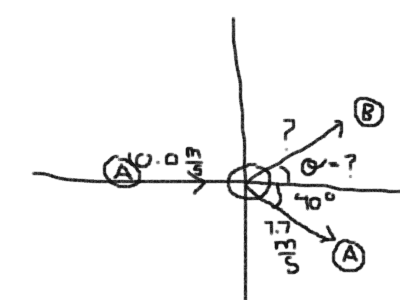

2D Momentum Problem with little info for Object
A 0.150kg billiard ball [A] is rolling toward a stationary billiard ball at 10.0m/s. After the collision, ball [A] rolls off at 7.7m/s at an angle of 40.0 degrees clockwise from its original direction. What is the speed and direction of ball B after the collision?
Conservation of Momentum
(Assuming I don't know the conservation of kinetic energy yet, or stuff about elastic/inelastic collisions)
Ok, basically I got any INFO I would need regarding [A], but yet I have no idea how to approach
X-component[MAVA + 0 = MAV'A + MBV'B]
Y-component[0 = MAV'A + MBV'B]
X [(0.150kg)(10.0m/s) + 0 = (0.150kg)(7.7cos[40]m/s) + MBV'B]
Y [0 = (0.150kg)(-7.7sin[40]m/s) + MBV'B)]
I don't have a clue as to how I will solve for the velocity, when I am lacking any info on mass..
Conservation of momentum is all that's needed. Remember: momentum is a vector quantity.
The equations you show can be solved for the x and y components of the momentum of ball B.
(mb)(vb)sin(theta) = (0.150)(7.7)sin(40)
(mb)(vb)cos(theta) = (0.150)(10) - (0.150)(7.7)cos(40)
Divide the first equation by the second and you should get tan(theta) = some number so you can solve for theta.
The deflection angle and velocity of B is all you need to deduce the mass of A, given it is stationary. Deducing velocity and incident angle of A is simple once you have the mass.
