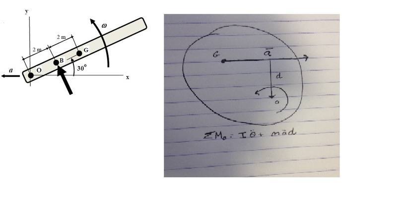

In the diagram attached a bar weighs 500 kg and is a 2D plane rigid body with mass centre at G. At the instant shown, the bar is moving horizontally at but reducing speed, causing horizontal deceleration as shown by vector a=-7i m/s2. At the same time, the bar is being raised rapidly by anti-clockwise rotation of the support structure with angular velocity of magnitude ωr=2rad/s. All other kinematic components can be ignored. Assuming the forces at B can only be applied in the normal direction and that the support at point O is a frictionless pin joint construct Newtonian equations of motion, and use just the moment equation about Point O to calculate the instantaneous force in the hydraulic ram at point B.
∑Fx = m*ax
∑Fy = m*ay
∑Mo = I*[itex]\alpha[/itex]+m*ad
I can see using the equations below that I[itex]\alpha[/itex]=0 as there is no angular acceleration. I am struggling to work out what the acceleration component is in the "m*a*d" part of the equation. Can anyone please have a go at explaining (not solving) how I can find it?
Thanks
Mark

The rod is rotating anticlockwise, at a constant angular speed, about one end as that end moves to the right and decelerates.
Presumably there is an unbalanced centripetal force on the rod com that points at O.
Anyway:
Can you state in words what the "mad" part of the moment sum represents?
You may need to consult your notes.
Looks like "a" is the linear acceleration of the center of mass and "d" is the perpendicular-to-a distance from the pivot to the center of mass.
Solved. Thanks
Well done :)
