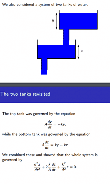

How exactly they combined equation1 and equation2 and got that system? I don't get that part.
A*(dy/dt)= -k*y eq1
A*(dz/dt)=ky-kz eq2
I tried substituting the 1st ky in the 2nd equation and then differentiating but I don't know how exactly they got that system which is:
d2z/dt2 + 2* (k/A) *dz/dt +(k2/A2)*z =0
I did not understand how they got that derivation of the system by combining equation 1 and equation 2.
I am willing to understand the concept, what are the steps, and the most important, how exactly to think to get that answer.
Any hint and tips will be much appreciated.
Thank you very much in advance.

Isn't it more logical to rewrite the first equation in terms of ##z## using ## y = {A\over k} {dz\over dt} + z ## ?

You want to eliminate y, so you express y in terms of z. Only the second equation allows that.

So you get $$y = {A\over k}{dz\over dt} + z $$ which means $$
{dy\over dt} = {A\over k}{d^2z\over dt^2} + {dz\over dt}
$$ and you substitute those in the first equation

I substituted and got like this:
A*[(A/k)*d2z/dt2+(dz/dt)]+ky=0
After that, I just did the multiplication and substituted the ky term with A*dz/dt+kz and still didn't work.

A{dy\over dt} + ky = 0 \Leftrightarrow A\left [ {A\over k}{d^2z\over dt^2} + {dz\over dt} \right ] + k \left [
{A\over k}{dz\over dt} + z \right ] = 0
{A^2\over k}{d^2z\over dt^2} + A{dz\over dt} + k {A\over k}{dz\over dt} + k z = 0
$$ Multiply left and right with ##k\over A^2## (*) and bingo.
(*) the reason for this is that it is convenient to have the highest order derivative with a coefficient 1.
