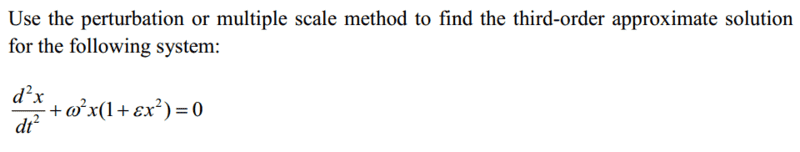

Hi everyone,
I need some help to solve this differential equation.
The question states "Use the perturbation or multiple scale method to find the third-order approximate solution for the following system:
diff(x(t), t, t)+w^2*x(t)*(1+epsilon*x(t)^2) = 0 "
Currently, I am still reading and studying on this perturbation method.
Any advise or directions of what I need to do is much appreciated.
Thank you for your help in advance.
John

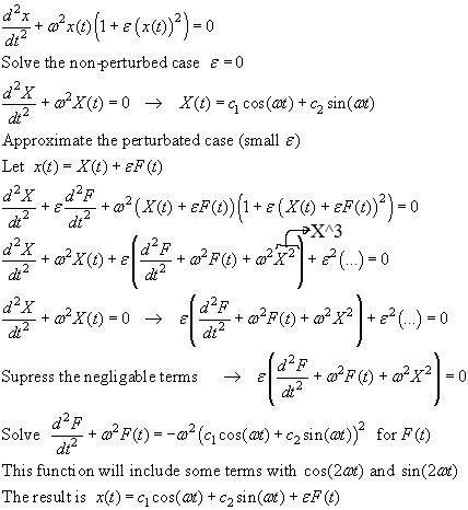

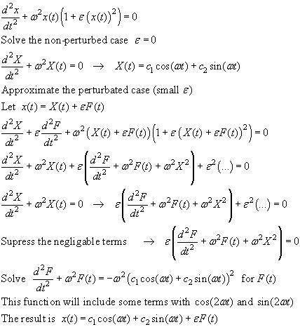

Hi !
First, solve the non-perturbated ODE.
Then, add a term with coefficient epsilon (see attachment) :

Hi JJacquelin,
Line 7 on your attached picture, I had a little different than yours. I had X^3 instead of X^2.
I am still working on it. Please let me know.
Thank you,
Hi Jhonmm !
You are right it isn't X^2 but X^3. This changes some terms of my comments, but this doesn't change the method to solve the problem. I suppose that you can continue by yourself.
