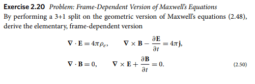

Also I'm stuck on how to perform the 3+1 split on Maxwell's Equations. What are the temporal and spatial components in the following equations?
For the first equation, I would think I should just use the temporal components of F, which would give me Gauss's Law and Ampere's Law. But I have no idea on how to do it for the second equation.

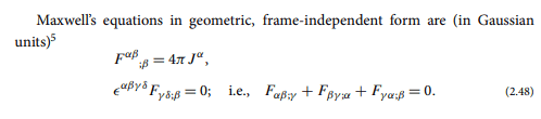

Regarding the 3+1 split of Maxwell's Equations, I think the question might be better formulated in this exercise of Kip Thorne's "Modern Classical Physics":
And equation (2.48) it refers to is:
If anyone could give me little help on how to do this.

Right. I'll talk to him to clarify what he meant by that.About Maxwell's Equations 3+1 split as formulated in this exercise. Would you be able to help me with this part? Because they involve the electromagnetic tensor and I have no idea on how to perform the split if not performing it for each term.
You need tho write down equation (2.48) component-wise, see in the video at time 1h30m56s:

I guess, he means the following assignments to indices. But, as @Dale mentioned, you can ask him.
The equation (2.48) in posting #7 is:
##\partial_\gamma F_{\alpha \beta} + \partial_\alpha F_{\beta \gamma} + \partial_\beta F_{\gamma \alpha} = 0##
You can set ##\alpha##, ##\beta## and ##\gamma## to any three of the four dimensions t, x, y, z (or 0, 1, 2, 3).
Take for example the spatial indices:
##\gamma = x##
##\alpha = y##
##\beta = z##
##\Rightarrow##
##\partial_x B_x + \partial_y B_y + \partial_z B_z = 0##, compare this divergence to left equation (2.50) in posting #7.
Take for example one temporal and two spatial indices:
##\gamma = y##
##\alpha = x##
##\beta = t##
##\Rightarrow##
##\partial_x E_y - \partial_y E_x + \partial_t B_z = 0##, this is the z-component of the right equation (2.50) in posting #7.
Likes Dale and jv07cs

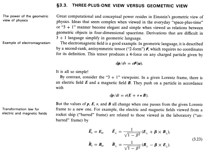

jv07cs said:
it kinda makes sense to me in this way looking at this paragraph in Kip Thorne's book
That quote does describe what "3+1 split" implies, yes. But, as noted above, it then obviously doesn't make sense for the EM field tensor; what Thorne is describing in that quote is not what you get when you "split up" the EM field tensor in a particular inertial frame.

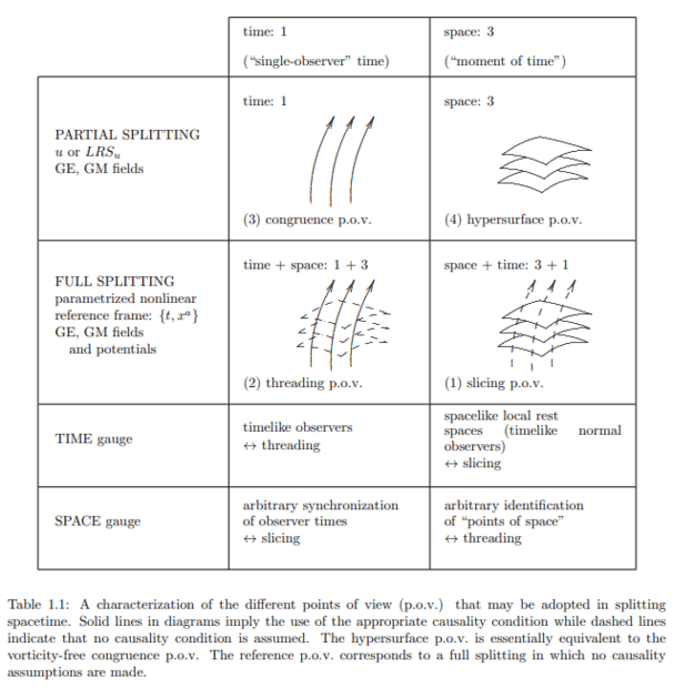

It might be worth nothing that there is an alternate way of formulating Maxwell's Equations, using a 4-vector potential instead of the EM field tensor. Since the 4-potential is a 4-vector, it does make sense to do a "3+1 split" on it: you get a scalar potential and a vector potential. The reason this is often not done is that the 4-potential (a) is not directly measurable, while the fields are; and (b) is not unique; there are many possible potential 4-vectors that give the same EM field tensor. (This is a consequence of gauge invariance, and picking one of the many possible 4-potentials is called "choosing a gauge".)
I think "3+1" is more about splitting "spacetime",
rather than splitting tensors into a vector-like object and a scalar-like object.
Upon splitting spacetime, one defines various parts of the tensor in terms of the split geometrical structures (e.g. projections onto hypersurfaces).
In some cases, it could result in a tensor decomposed into a vector-like object and a scalar-like object,..
but it need not be, as we see with the electromagnetic field tensor.
  • https://doi.org/10.1093/acprof:eek:so/9780199205677.003.0002
    Ch 2 THE 3+1 FORMALISM
    Introduction to 3+1 Numerical Relativity
    Miguel Alcubierre
    (abstract)
    ... This chapter focuses on the 3+1 formalism, where spacetime is split into three-dimensional space on the one hand, and time on the other.
  • https://arxiv.org/abs/gr-qc/0703035
    3+1 Formalism and Bases of Numerical Relativity
    Eric Gourgoulhon (LUTH, CNRS / Observatoire de Paris)
    (Ch 1 Introduction)
    The 3+1 formalism is an approach to general relativity and to Einstein equations that relies on the slicing of the four-dimensional spacetime by three-dimensional surfaces (hypersurfaces). These hypersurfaces have to be spacelike, so that the metric induced on them by the
    Lorentzian spacetime metric [signature (−, +, +, +)] is Riemannian [signature (+, +, +)].
  • https://www34.homepage.villanova.edu/robert.jantzen/gem/
    Understanding Spacetime Splittings and Their Relationships or
    Gravitoelectromagnetism: the User Manual
    Robert T. Jantzen, Paolo Carini, and Donato Bini
    June 9, 2004
    Maxwell's Equations are discussed in Ch 4.
  • Gravitation
    Misner, Thorne, Wheeler
    Maxwell's Equations are discussed in Ch 3.4.
UPDATE: There's also a 2+2 splitting
  • https://arxiv.org/abs/gr-qc/9510040
    Covariant double-null dynamics: (2+2)-splitting of the Einstein equations
    P. R. Brady, S. Droz, W. Israel, S. M. Morsink
    The paper develops a (2+2)-imbedding formalism adapted to a double foliation of spacetime by a net of two intersecting families of lightlike hypersurfaces. The formalism is two-dimensionally covariant, and leads to simple, geometrically transparent and tractable expressions for the Einstein field equations and the Einstein-Hilbert action, and it should find a variety of applications. It is applied here to elucidate the structure of the characteristic initial-value problem of general relativity.
So,
3+1 is useful for the Cauchy Initial Value Problem (data given on a spacelike initial-data surface).
2+2 is useful for the Characteristic Initial Value Problem (data given on one or more null hypersurfaces).
Likes Antarres and Dale

Alternative to the calculation in my posting #15:
The bottom equation (2.48) of Kip Thorne in posting #7 is called "Bianchi Identity", according to Leonard Susskind. From my viewpoint, this is not the most intuitive starting point to derive the 3+1 notation of Maxwells equations.
If you look at equations (2.50) in posting #7, then you see, that the two bottom Maxwell's equation look almost equal as the two Maxwell's equation at the top, if you exchange E and B. The only difference is a sign and the fact, that the right sides of the equations are zero. That is, because no magnetic monopoles exist.
In the following video they derive first both top equations in (2.50) in posting #7 from the top equation (2.48), containing the EM field tensor:
##\partial_\beta F^{\alpha \beta} = \mu_0 J^\alpha##
Then they derive both bottom equations in (2.50) in posting #7. For this they use the dual tensor, wich is the EM field tensor, except an exchange of E and B, with additionally some sign changes:
##\partial_\beta G^{\alpha \beta} = 0## (no magnetic monopoles)
