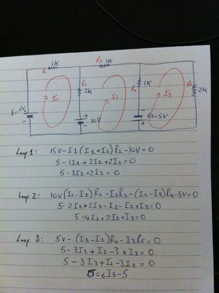

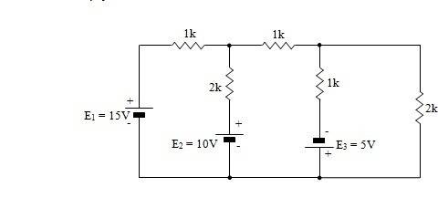

1. Using Kirchhoff’s Laws, find all the currents flowing in the circuit.
2. Hence, determine the voltage across each resistor and show that all loops comply with KVL
KVL and KCL
Please see the pictures attached

Hi amy1983, Welcome to Physics Forums.
For your Loop 2 equation be careful about the orientation of the voltage sources; as you go around the loop in the direction of mesh current I2, both give potential rises.
Take another look at your Loop 3 equation. Again, pay attention to the voltage source polarity with respect to the current loop direction. Also check that you haven't inadvertently counted some voltage drops twice...
It's a bit confusing because you've taken clockwise mesh currents as negative. Also that loop 2 is not correct. As Gneill said, you've made an error with values of the voltage sources in that loop.

Hi g/neill / NewtonianAlch, I typed it all up and came up with the following according to your suggestions:
At node V_1,
I_1+I_2-I_3=0
⇒I_1+I_2=I_3
⇒(15-V_1)/(1 k)+(10-V_1)/(2 k)=(V_1-V_2)/(1 k)
⇒(30-2V_1 )+(10-V_1 )=(2V_1-2V_2)
⇒40-3V_1=2V_1-2V_2
⇒5V_1-2V_2=40
At node〖 V〗_2,
I_3-I_4-I_5=0
⇒I_3=I_4+I_5
⇒(V_1-V_2)/(1 k)=(5-V_2)/(1 k)+V_2/(2 k)
⇒2(V_1-V_2 )=(10-2V_2 )+V_2
⇒2V_1-V_2=10
At node V_1,
I_1+I_2-I_3=0
⇒I_1+I_2=I_3
⇒40-3V_1=2V_1-2V_2
⇒5V_1-2V_2=40
Okay, looks good for Node V1.
At node〖 V〗_2,
I_3-I_4-I_5=0
⇒I_3=I_4+I_5
Oops. Check the polarity of the E3 source. Is it going to make the potential difference across R4 larger or smaller?
⇒2V_1-V_2=10

Hi gneill, Thank you for your advice. Does the remainder of the equation look okay?

Oops again. I think you added the V_2's from the right hand side to the left hand side rather than subtracting them from both sides. But you're getting there...
I_3-I_4-I_5=0
⇒I_3=I_4+I_5
⇒(V_1-V_2)/(1 k)=(5+V_2)/(1 k)+V_2/(2 k)
⇒2(V_1-V_2 )=(10+2V_2 )+V_2
⇒2V_1-2V_2=10V_2+2V_2
⇒2V_1=10V_2
⇒2V_1-V_2=10
I know it's bad, but I am finding this electrical element difficult.
:/ Worst case scenario if I put up what I have at least it shows I made the effort!

You seem to be having difficulty expanding and then collecting terms. On the LHS you've got: 2*V1 - 2*V2. On the RHS you've got: 10 + 2*V2 + V2 = 10 + 3*V2. So:
2*V1 - 2*V2 = 10 + 3*V2
Move the 3*V2 from the RHS to the LHS by subtracting 3*V2 from both sides. Then proceed.
I know it can be tricky, and much of circuit analysis involves a good deal of finicky algebra. But you are indeed showing good effort and insight for what you need to do to get the result. As they say, the devil is in the details :smile:
