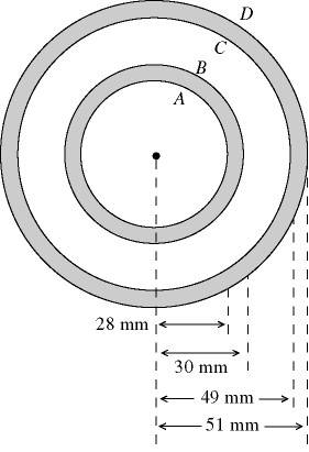

The cross section of a long coaxial cable is shown, with radii as given. The linear charge density on the inner conductor is-10nC/m and the linear charge density on the outer is -40nC/m. The inner and outer cylindrical surfaces are respectively denoted A,B,C and,D ad shown. The linear charge densities on surfaces C and D, in nC/m, are closest to:
A) +10 and -40
B) -10 and -30
C) 0 and -40
D) +10 and -50
E) -30 and -10
I'm not exactly sure what to do...
The only thing i could think of was that the system is a conductor so the inside charges must be equal to zero and so i thought that what ever the inside charges added up to then the outside charge would be the same magnitude as the sum of the inside charges but opposite in sign. I don;t even know if that is conceptually correct ...please help ...i don;t think i understand the underlying concept of this question...let alone actually solving it haha.
The correct answer is B) -10 and -30. The charge density of the inner conductor is -10 nC/m, and the charge density of the outer conductor is -40 nC/m. Since the system is a conductor, the total charge on the inner conductor and the total charge on the outer conductor must be equal and opposite. Therefore, the charge density on the outer conductor must be -10 nC/m + (-40 nC/m) = -50 nC/m. This means that the charge density on the inner conductor must be -30 nC/m.
