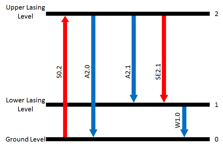

1. The problem statement
The problem is to use Matlab to modelling the 3-level rate equation of a solid-state laser.
The picture shows the simplified energy levels and transitions of the laser.
S0.2 is the absorption from ground level (L0) to upper lasing level (L2).
A2.0 is the spontaneous emission from upper lasing level (L2) to ground level (L0).
A2.1 is the spontaneous emission from upper lasing level (L2) to lower lasing level (L1).
SE2.1 is the stimulated emission from upper lasing level (L2) to lower lasing level (L1).
W1.0 is the fast non-radiative decay from lower lasing level (L1) to ground level (L0).
In this problem, the absorption S0.2 is triggered by pump laser source with intensity of Ip, stimulated emission SE2.1 is triggered by signal laser source with intensity of Is.

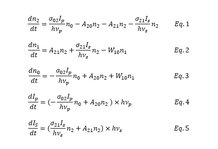

I've written down the rate equations according to the energy levels and transitions like follows:
where n2, n1 and n0 are the populations of the state in upper lasing level (L2), lower lasing level (L1) and ground level (L0), respectively. σ02 and σ21 are the absorption and stimulation emission cross section of S0.2 and SE2.1 transitions. A20 and A21 is the Einstein coefficient of transition A2.1 and A2.0. W10 is the rate of the fast transition W1.0. h is the Planck's constant, vp and vs are the frequencies of the pump laser and signal laser. Ip and Is are the intensities of the pump and signal laser.
The main idea of this modelling is to observe the change of the population of the state in each level and the change of the intensity of both the pump and signal lasers.

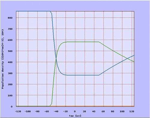

With a reasonable pumping level, I expect to see something similar like this:
where the green curve is the population of upper lasing level, blue curve is the population of ground state, orange curve is the population of lower lasing level.
At the moment, the model is not fully completed yet. I need to find out a way to continuously pumping the system for a while rather than just giving an initial pumping energy.
If I want to get the population inversion of upper lasing level and ground level (i.e. n2 > n0) like showed in the figure, I have to set the initial value of y(4) to 30000 (in the unit of W/cm2), which equals 30,000 J in energy in this modeling.

If I am not wrong, there is 'area' missing in equations 5 and 6 if one expect change in intensity. As it is now, the unit will be energy per unit time- basically the power. But in other equations, Is means intensity, of course not the power.
