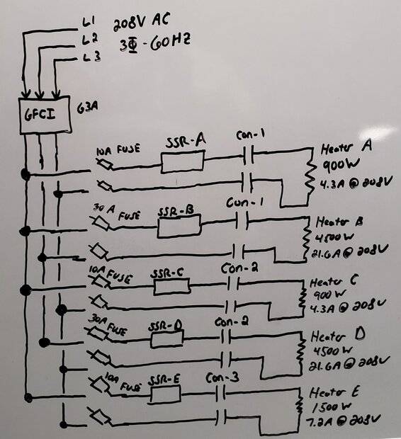

I have a 3 phase problem that I think might be applicable to this forum. The setup is equipment which contains 5 resistive heaters (A through E). The unit is powered by 208V 3 phase and each of the heaters are hooked up line to line in an unbalanced configuration as follows:
L1-L2: Heater D (21A FLA)
L2-L3: Heater B (21A FLA)
L3-L1: Heater A (4.3A FLA), Heater C (4.3A FLA), and Heater E (7.2A FLA) for a total of ~15.8A FLA

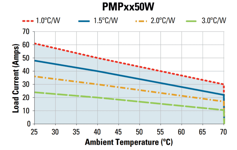

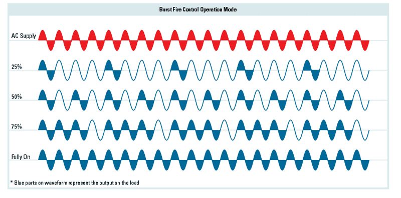

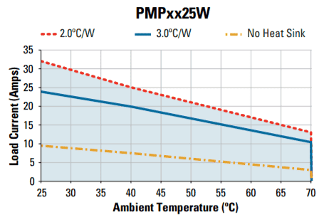

The power to each of these heaters are controlled via zero-cross SSRs with each using their own dedicated 4-20mA control signal. I am measuring a heavy degree of all harmonics (including DC component) when all heaters are running in PID control to adjust current to maintain temperature. These harmonics disappear when the SSRs are forced to 20mA (full power) and when they are driven to 4mA (no power). The issue I am seeing is that randomly, after anywhere between 3-10 days, some or all of my SSRs will just stop working. They become completely unresponsive to command signal changes and can only be recovered by removing the 4-20mA signal completely for some duration of time and then re-applying.
During the past 3 months of being plagued by this issue, I have been monitoring the voltage and current of all 3 phases and do not see any voltage spikes, dips or other anomalies which could be the cause of failure. I was also continuously monitoring the 4-20mA signal to see if control power is timed out by chance which might have caused this issue. I am currently investigating to see if the harmonics present might be tripping up the zero-cross detector circuit internal to the SSRs. Can anyone give me some feedback about potential issues with this configuration or if they have ever heard of such an issue affecting SSRs?
The SSRs that I am using are Crydom PMP series.
