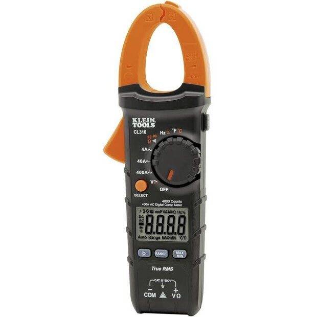

Think of the shared conductors like this:
If you are familiar with an amp clamp like these:
Then you realize you can clamp around a wire and measure the current it's carrying. You can also clamp around several wires and measure the current vectorially summed together. So if you had a situation where you had three separate transformer/load pairs all 120° out of phase you could group several wires and find your meter would tell you 17.33 amps when measuring two 10 amp loads from sources 120° out of phase. Maybe this makes more sense for you?
