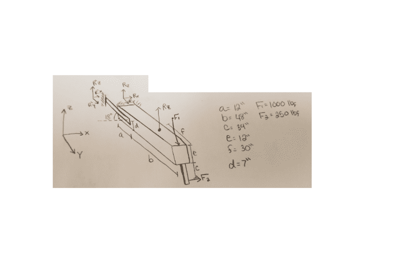

Hello, it has been quite some time since my statics class, and I am having a problem determining the reaction forces and moments in a rigid body. I have included a sketch of my problem, and I am hoping someone can help guide me to a solution. I apologize if the sketch is a bit crude.I have a beam that is fixed at one end. On the opposite end, there is a vertical force acting directly on the beam (F1 = 1,000 lbf), and a horizontal force acting on a bar attached to the beam (F2 = 250 lbf).
The beam is supported by a roller, and has a reaction load in the vertical directly only, located 30 inches from the end of the beam.
The beam is also supported by a rod, located 12 inches from the fixed support, and the rod is at an 18 degree angle.
I am trying to find the reaction Forces as well as the Moments to show this scenario in static equilibrium.
Thank you.

Can you describe the application? 1000 pounds is a lot of force...
I just gave made up numbers just to get an idea how to solve such a problem. I agree, the forces may not translate well to the size of the beam. Any force would work.
Sum forces in the x, y, and z directions and equate to zero. Also choose a convenient point(s) to sum moments around and equate to zero. Start here and let's see how many unknowns you have. Also since it's a 3D system I would recommend using cartesian vector notation.

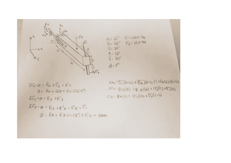

I think the added fixed rod is causing me some issues. I tried summing the forces and moments, and got the following in the attached sketch. I think the forces are right, but I am not sure the moments are accurate...
