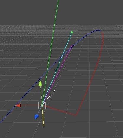

Hi everyone,
I'm a software engineer (sorry in advance if I made/will make some math mistake) and I'm trying to calculate the projectile motion from one point to hit a specific target in a 3d space so that the parabola will lie on an arbitrary plane.
Is several days that I'm trying to achieve this without any luck, I'll be glad for any help... i should really finish this work at the most in a couple of days...
Currently I've got my parabola working without rotations on the Z/X axis so I can hit any target with a parabola lying on a plane perpendicular to XZ (see attachment, the green line is the velocity vector).
What I would love to do is calculate the other parabolas that can hit my target (lying on some other planes) if possible specifying a rotation angle (around the axis that goes through start and end point maybe?)
Hope my problem is clear enough...
Anyway that's what I'm currently using.

Now as I said this works just fine, I've my projectile hitting the target without any problem.
I think I should act on [tex]x_p, y_p[/tex] and on the gravity vector but I cannot get it to work...
Thank you in advance.
edit:
if it's not clear enough please let me know and I'll try to explain myself in a better way, unfortunatly as you could've noticed my mothertongue is not english...
edit2:

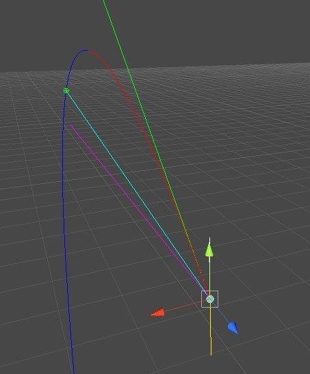

modified the first screenshot and added a new one to show the goal the I would like to reach (i got something close to it cheating on the math...)

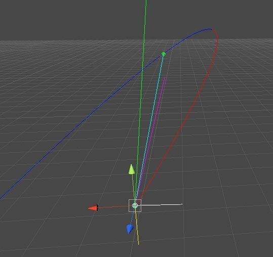

Hi Petr and thank you for your reply.
unfortunatly I've already tried that one and it doesn't give me the desired result.
If you see the new screenshot attached to this post you can notice that in that way (well I'm using quaternions instead of a matrix but it should be the same) the all parabola rotates around the axis while a need the start (point with the axis displayed) and the goal (green sphere at the end of the cyan line) to be fixed so that i can launch my projectile from my start point to hit a specific target as like an "effect/curl" is applied to the parabola.
in the screenshot I'm applying a rotation around the cyan axis, I've also tried around the magenta one (direction on the XZ plane) with similar result.
The first red segment from the start point to the start of the parabola is displayed only because I'm assuming that the start point is always the first point (t=0)

I dont' understand what you want to rotate.
With the coordinates of cannon and target, gravitiy and initial velocity fixed there are only two trajectories your projectile can take to hit the target. Both lie in the same plane.
If you want to achieve a trajectory similar to the parabola in your second screenshot, without using rotating projecting of some other external force like wind, etc. this is impossible.
Yes i would like to achieve a trajectory like the second screenshot.
It's ok to use rotation/projection but when I try to use them my result is like the third screenshot so that it doesn't start on my start point and it doesn't hit the target (like the second screenshot)
I think is because I'm applying the rotation after calculating the point at the time [tex]t[/tex], maybe I should act on the formula before it?
Ok, so you want to rotate the parabola taking initial and final points fixed. This should be the solution:
