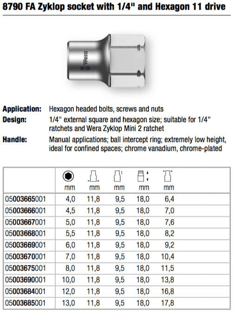

I found a Wera socket whose overall length is 18 mm.
It is driven by a 1/4" external hex. So I could use a box end wrench to rotate it. This seems to be the smallest mass produced profile tool I could find for a non-damaged 10 mm bolt or nut, requiring only 18 mm above the nut or bolt.
This won't work for my application. I'm trying to remove a bolt on a transmission pan that is right up against the subframe with very little clearance. 18 mm is to large. I can't find something smaller. Can someone with a 3D printer make a smaller 10 mm socket? Not sure how much this would cost. Or if someone has gone to a professional company that manufacturers custom tools, how much would something like this cost? This is merely out of convenience for me. I could always go through the hassle of undoing one of the mounts and jack it up. Much faster if I can just get a slimer profile socket. So if fabrication of a smaller socket will cost way to much money, then it's not worth it to me.

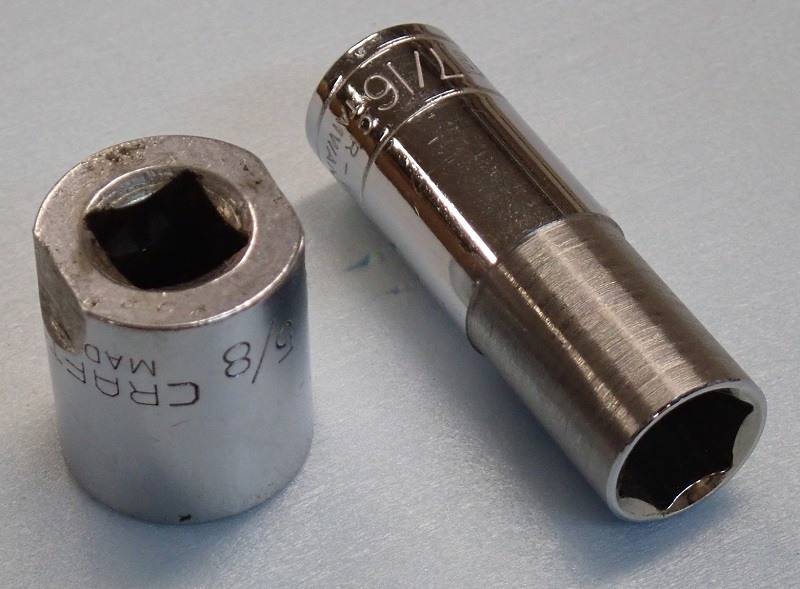

I have solved similar problems by modifying purchased sockets. The socket on the left was modified for an application similar to yours. It has two flats ground so that it could be turned using an open end wrench. It think it was for removing a bellhousing that was up tight against the firewall. The socket on the right was turned down to fit a nut inside a tight hole.
Likes berkeman and hutchphd

Otherwise @jrmichler has the right idea. Modify an existing socket. If you're going to start grinding on one you can also grind it more shallow to help with clearance.

It does seem that a lot of the offset box wrenched I've seen do have a thick wall. They are likely inexpensive wrenches worth the risk of ruining one by grinding them smaller. But I would modify a socket ahead of modifying an offset box wrench.
Can you maybe just weld a hex nut on the top end of a low-profile socket, where the ID of the hex nut matches the OD of the socket? You might need to clean the threads out some inside the nut to get a good friction fit on the socket body before tack-welding it on...
EDIT -- I suppose you could also just lay the nut on top of the socket and tack weld it to the end; it doesn't have to friction fit over the end of the socket. Use a thin hex nut to give you more clearance as well...
